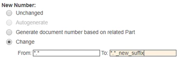

I was able to add suffix to all parts using "set new name" in windchill. I've attached screenshots below.
My question is how would I go about if i had to remove the new suffix from the name and go back to only the base number?

Have you tried the "reverse" of your original change pattern? Like this:
*_suff.* --> *.*

manny11-VisitorAuthor
January 13, 2020
The base numbers will be different but the suffix are the same.
for example 123456_suff  >>> 123456
                    245365_suff >>> 245365
so different base numbers that i want to keep but knock off the same suffix at the end.
*_suff.* --> *.*
