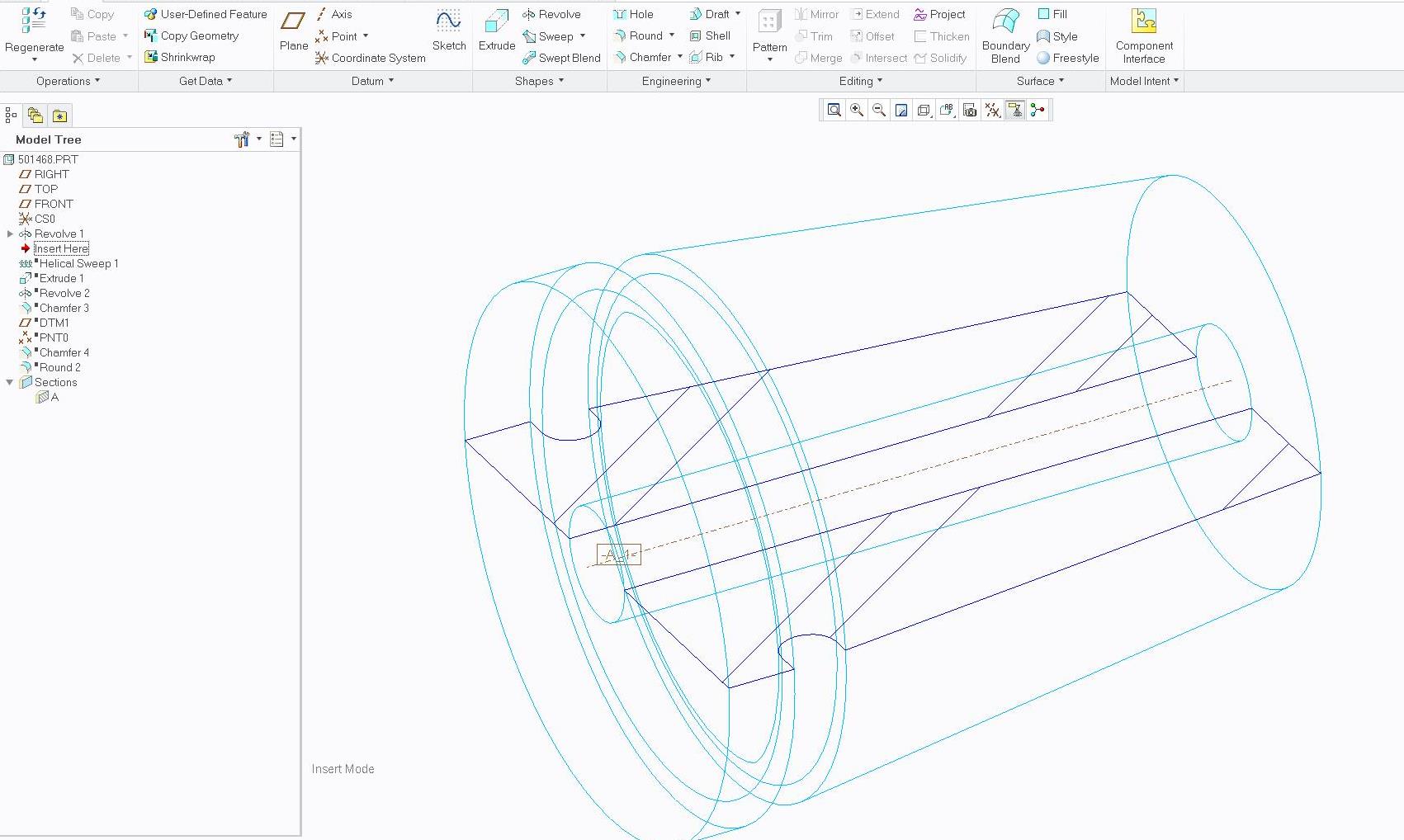

Why can't I remove this Datum A_1 tag? I don't even see it in the model tree!
January 27, 2014
Revolved items get an automatic axis. That is what A_1 is from. Select it and use Properties for it to unset the datum.
