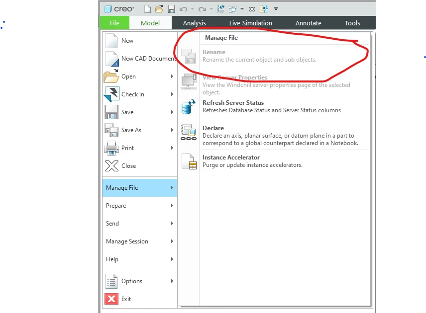

Rename feature
How do turn on ''rename'' feature?
you use Windchill therefore Rename command in Creo is disabled by default.
Solution: Rename Creo prt/asm/drw in Windchill environment.

Nov 24, 2023 12:25 PM UTC
Great, thank you
