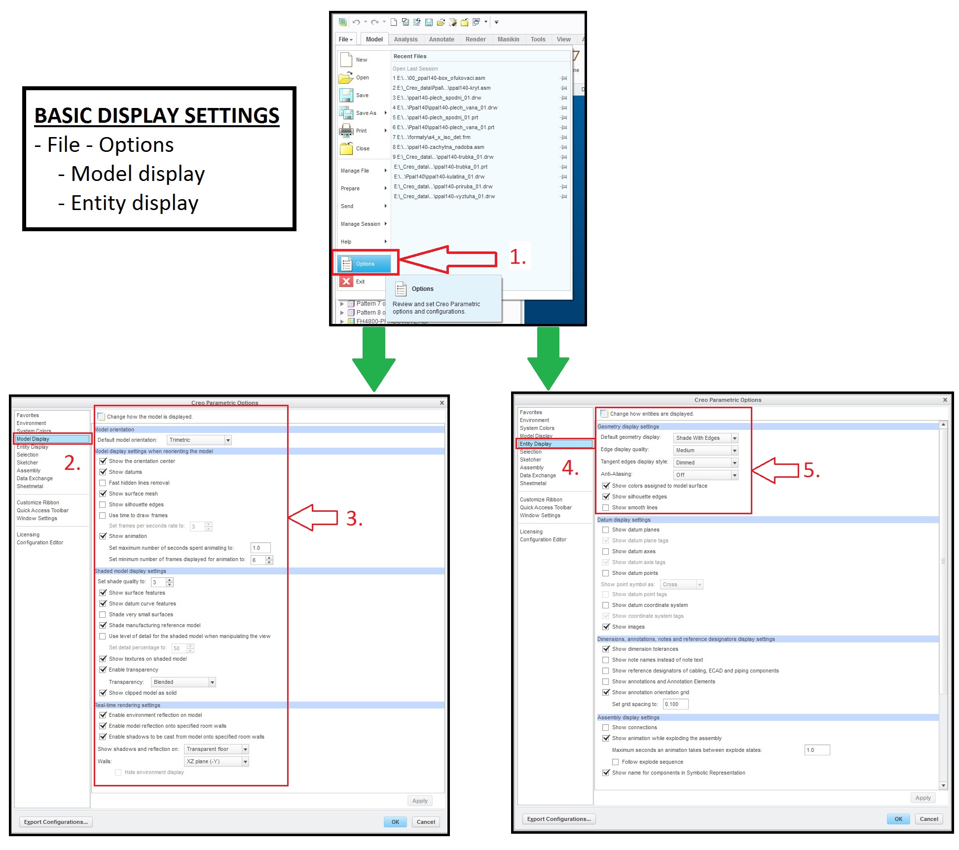

if you want something like Josef Lada picture style try play with following settings.
Make simply printsreens! Think you are not able to create "thick countour lines" in render or ARX (Advanced Render Extension is not free modul) mode.
Be ready for rapid hardware requirements increase. ---> prepara colors, views etc. and AFTERWARDS increase your settings.

Shaded with edges can be very nice if you play with some of the other quality settings in the configuration options settings.
Play will all the quality settings until you get what you want.

rm�ller4-ParticipantAuthor
April 28, 2016
Oh well thank You both very much, this is the solution I was thinking about and I feel little ashamed I was not looking for this at first because Im student and early user of CREO at all.
So thanks also for respectful answer and hints, Im not used to have such pleasant attitude.
