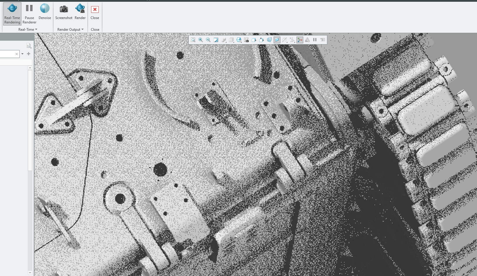

RENDERING issue. How can I make it look better.
RENDERING issue. How can I make it look better?. Cannot change my Graphic Card, Cannot change my laptop DELL P7770. Please drop your comments for better pixel picture. See Image
THANKS IN ADVANCE

which Creo version do you use?
Rendering is executed by Keyshot engine. By default rendering is done by CPU.
Suggestion:
Open Task Manager and activate Performance tab. You will see the load of CPU/GPU/Memory.
Information shown by Task Manager can explain the behavior of Creo rendering operation.

Its CREO 10. Also, See Image

CPU load shown on published image tells you that CPU resources are completely exhausted.
Note: I do not understand why CPU is running and 2.5 GHz frequency, only.
I think that i7-12850HX processor is not suitable for complicated rendering tasks.
Suggestion: Create simple model (eq. cylinder) a test its rendering.
According to https://www.intel.com/content/www/us/en/products/sku/228442/intel-core-i712850hx-processor-25m-cache-up-to-4-80-ghz/specifications.html document, the processor contains:
  • 8 Performance-cores ... Max Turbo Frequency 4.80 GHz ... 16 Threads
  • 8 Efficient-cores ... Max Turbo Frequency 3.40 GHz ... 8 Threads
I guess Keyshot engine does not like shared use of fast and slow cores. You can try disabling the use of slow cores.
RAM
How much memory is consumed by rendering? Please publish picture of Task manager, again.
GPU
What GPU is installed in your computer. I guess that it is not supported for running rendering tasks.
https://support.ptc.com/help/creo/creo_pma/r10.0/usascii/index.html#page/rendering/rendering_configuration_options.html#
I think that your config.pro does not contain advanced_rendering_mode option. This means that advanced_rendering_mode auto is set by default -AND- Creo "Runs Render Studio in GPU mode if the system hardware supports it, otherwise runs the application in CPU mode."

Post your settings that you use for rendering.
