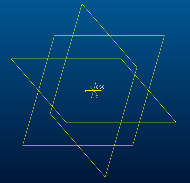

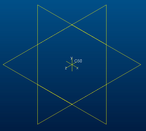

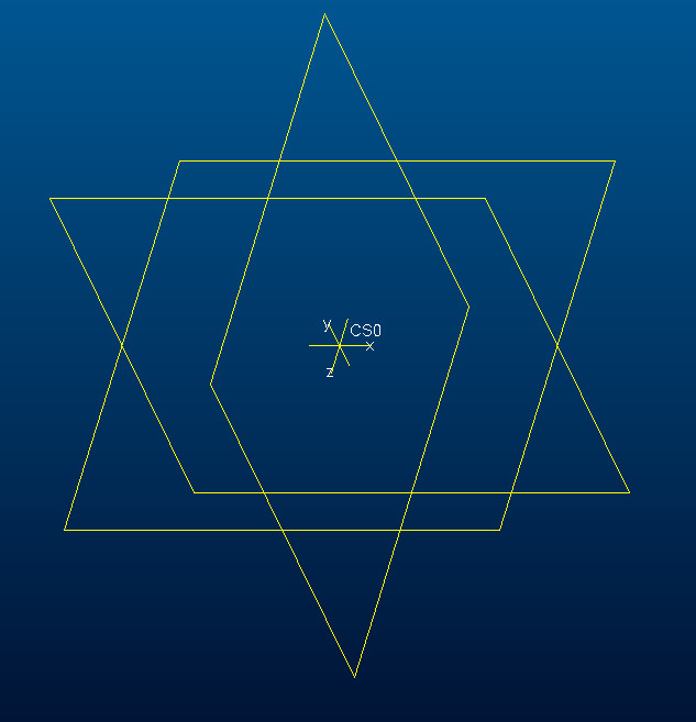

Hi all,
Actually i need to re orient the X Y Z plane(Default coordinate point) as mentioned in the below picture. And i do not want to delete the existing default coordinate point. So what i have done means, Just I have rotated the coordinate point(XYZ) as per my requirement and set the views and renamed the planes also. Now i have achieved what i expected.
But the problem is the standard orientation(Ctrl+D) view, I have modified all other views. When i give standard orientation view the model or assembly view shows reversible & improper view.
I have not able to modify the standard orientation view. Kindly suggest
1) how to modify standard orientation(Ctrl+D) view.
or
2) How to achieve the required view xyz coordinate point with the existing coordinate point.
3) The below mentioned x y z directions are correct? And what is the correct x y z directions?
4) What is global coordinate system directions?
5) What system PTC follows and why?
Expecting your suggestions guys. Thanks in advance

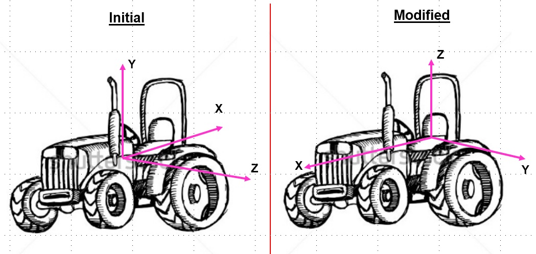

There are two common coordinate systems. For aircraft, Y is up, X extends from nose to tail and Z is from fuselage to port wingtip. The other is that X points to port, Y to the rear of the vehicle and Z is up.
The global system is not visible, but a default CSYS is aligned with it.
PTC/Creo doesn't really follow any system - it is typically handled by creating default/start parts that are unique to whatever company/user wants along with view orientations.
What you have specified is 90 degrees rotated from other standard coordinate systems, which is why it is not the default.
What may be an additional problem is determining if you are using 1st angle (European/ISO) or 3rd angle (US/ANSI/ASME) projections. From the look of it you are using 1st angle.

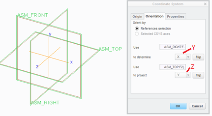

The Standard Orientation can't be re-defined. The default coordinate system is defined with X and Y in the plane with X pointing to the right, Y pointing up, and to complete the right hand coordinate system Z points toward you.
June 9, 2016
I'm not sure why you would need to rename the planes or reorient the views (other than to swap "LEFT" for "RIGHT")... those should already be pointing in the "standard" directions by default.
All it sounds like all you need is to reorient x,y,z of the default csys.
Can you redefine the csys orientation to point how you want?
This assumes you have three planes as the first three features in the model tree, then the csys as the fourth feature, referencing location & orientation to the planes.
(In this example, you'd change the Right plane to point Y, the Top plane to point Z):

Hi
Abrian,
What you have said here is for new coordinate system. it is possible and not for existing default csys in the 4th item of the model tree as you said.
Now i need to try "Gabrial" sharing on config option.
Actually my initial and modified csys are here. I have rotated and reoriented the default csys and created my "start part" like this only. These kind of modification will affect any other function in future? or it is normal?
And i have chosen this xyz orientation from this standard "ISO 8855".
David, We are using third angle projection only.
