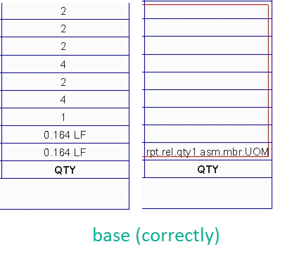

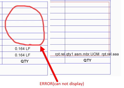

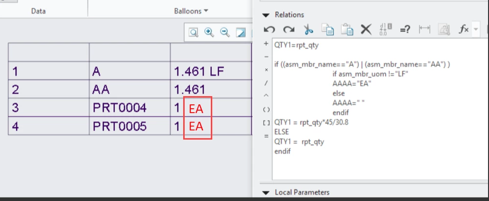

I have an problem about the table.
The user defined parameter can not displayed after i add some new code.
                                        PIC 1
                                               PIC 2
                                                         PIC 3

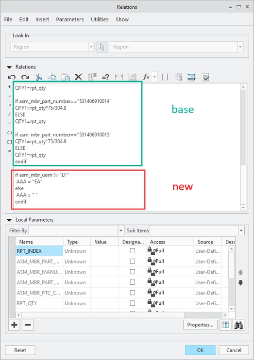

When i add the new code in PIC 3. The parameter (QTY1) can't correctly display after update table (see PIC 2)
I don't know what went wrong. There is no problem with the new code.
October 15, 2020
i use an other code instead of the NEW CODE in PIC3 which solved the problem of user defined parameter (QTY1 ) display.

Can you upload a sample file and state what version of Creo it was created in?
October 15, 2020
Please see attached for base code. I used another form of code to solve the problem.
October 15, 2020
CREO 4.0

look at base code ... endif command is missing at the end of first if command.
October 15, 2020
Sorry,  i deleted the ENDIF in PIC 3 by accident  which made the code looks have some bug. But the lack of ENDIF does not exist in the base code.

Looks like you're missing an 'ENDIF'.
October 15, 2020
Sorry,  i deleted the ENDIF in PIC 3 by accident which made the code looks have some bugs. But the lack of ENDIF does not exist in the base code.

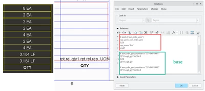

October 12, 2020
@ZC_8293506
Relation as in image may help....
EDIT: If this doesn't work, share a sample file and replace the report parameter asm_mbr_name with asm_mbr_part_number or as per your use case with appropriate values.

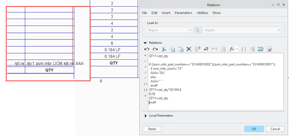

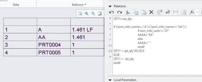

October 15, 2020
Thank you for your new idea !
But it look like another user defined parameter "AAA" can't display correctly. Creo4.0 is strange😂
The error also exist in your screenshot
ZC_82935061-VisitorAuthorAnswer
October 15, 2020
October 15, 2020
Of course . I don't know what's wrong with the code (in PIC3) I added before. But they do cause the display error. 😰
