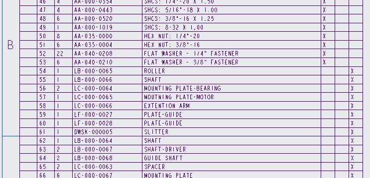

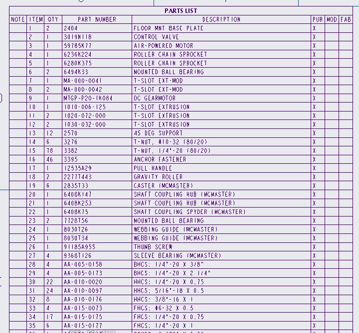

Any help to get my BOM to sort as expected would be appreciated.  I have the following
&asm.mbr.purchased Backward
&asm.mbr.fabricated Backward
&asm.mbr.part_number Forward
but the part numbers are not going in order.
CREO 7.0.6.0
Feb 8, 2023 4:43 PM UTC
So I think you found my issue.  I recently changed my start part to have the Purchased and Fabricated parameters as restricted.  In doing so it is putting a "space" in the parameter if I don't select anything.  To test this, I put a space in an older part and it moved up in the BOM to where it should be.

My next best guess:
I had been thinking there may be an issue with the Fabricated column because the sort is in sets of part number order.  This morning I remembered something that is slightly annoying to me.  When using Edit / Attributes in the windchill workspace, you cannot delete all text from a string parameter.  You are forced to replace the text with a space to make it blank.  The only way to remove all characters is to use the parameters editor in creo.
I believe that your fabricated column contains space characters in some, X in some, and nothing in the rest.  And creo is sorting based on those three values - "blank", "space" then X.
I also introduced this into a modified BOM and added a space in a part parameter which changed the sorted location of the part.
MYR_Industries12-AmethystAuthorAnswer
