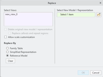

Replace view model
I'm using Creo Parametric 8.
When I try to replace a model of a view the OK button is still greyed out.
I am seeking clarification on whether the "Replace by Reference Model" option is designed for specific cases or if it is intended for use with any model replacement.

Reference model in this context applies to the use of Merge and Inheritance, shrinkwrap features. Refer to the article below for more information.
Article - CS109945 - How to replace 3D model in drawing in Creo Parametric (ptc.com)
