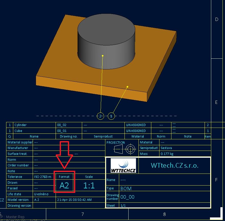

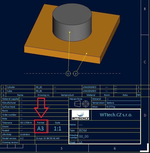

April 28, 2015
Hi Tommaso,
OK, still you didn't answer why you need to change BOM table? The reason why Im asking is: I notice in your clip that you've replaced table with other table with different amount of items. So if you are doing that, the assembly also has been changed (you get new revision) ?
I´m trying to find reason, and I apologise if you wanna keep your reason.
I presume that you had replace some parts in assembly and after that you need fresh BOM table ??
If you´re trying to change table with previous parts replacement and changing assembly, you dont need to insert new table. It automaticlly regenerate, and reorder ballons. And if you are missing some ballons just add them into drawing.
Of course you maybe already know this, but Im short in your answer before.

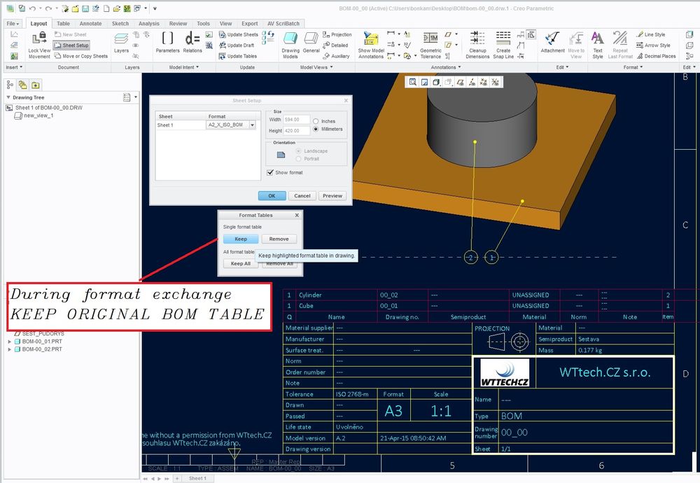

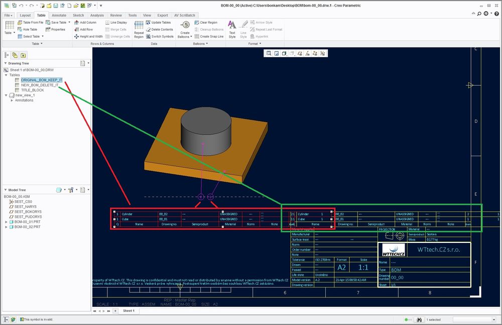

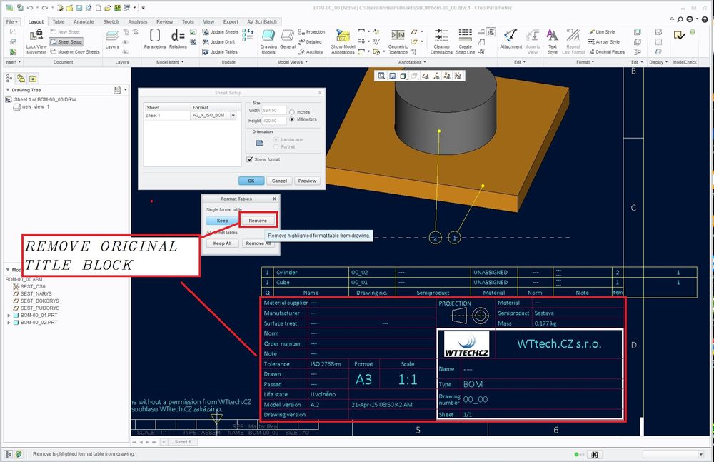

My praxis is following:
STEP 01: Create a assembly BOM drawing
STEP 02: l need change drawing format and KEEP BOM baloons
STEP 03: KEEP ORIGINAL BOM TABLE and remove original Title block
STEP 04: After format exchange, there are two BOM tables. DELETE new BOM table and move original one als you wish.
STEP 05: Result: Format was chnged and BOM baloons are kept.
l hope it can help you...
