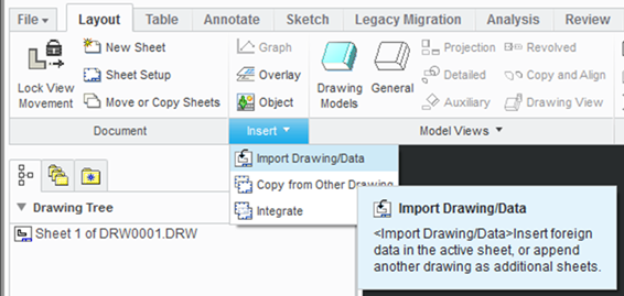

June 10, 2016
You can add drawing in new sheet with insert--> import drawing/data, where you will get new model & drawing. Once you are complete then you can delete first sheet and associated model. I think it might help you..
Jitu
