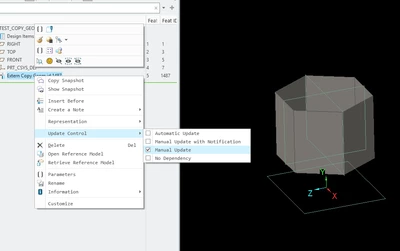

Dec 2, 2025 5:15 PM UTC
Why not just set the update control for the copy geom feature to "No Dependency" ?
Michael_10-MarbleAuthor
Dec 3, 2025 1:45 AM UTC
I want to update the model such that the references are all set to the new surface which will be created early on in the model.

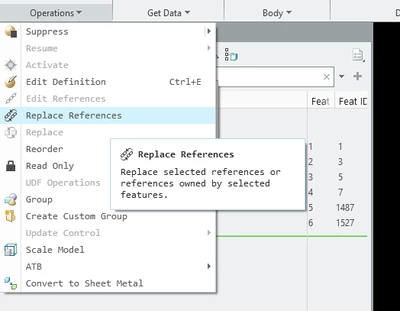

Dec 3, 2025 2:39 AM UTC
Try inserting your replacement quilt right after the copy geometry feature.
Then select the copy geometry feature, and use the "Replace References" tool:
Replace the references with the new quilt.
If successful, you can then delete the copy geom feature as all downstream features will use the new one.
