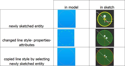

I got a bunch of quite complex sketches, that serve as gasket centerline in the part.
to better see them in the skeleton model assembly, I changed properties of those sketches to a random, different than default appearance.
then, as I wanted to go back to their previous style , I've drawn a new sketch and in properties of the sketch copied the style from existing and selected that new entity.
result is far from expected, as now I have a line, that is visible the same in 3d, but in different color inside the sketcher compared to fresh sketch.
Any tips in resetting the line style of entities that were changed to default style without the need to re-draw all of them again  ?

Regrettably, I don't see any way to get the "default" properties for sketch entities to be restored. Seems that once you've set the color of the entities, they will always show the same color as they have in the sketch. You can't return them to showing one color when you're in sketch mode and another (the default sketch color) when you're in part/assembly mode. There's no "cancel all formatting" or whatever like there is for surface/solid appearances (where the part turns that ugly grey).

I tried resetting line properties in Creo 7 and CreoPlus (12).  I could not find a way to reset the line properties.  Even using select and selecting an original line did not achieve a reset.

I'm not sure.  On my system (creo 10) - the custom properties revert if I set them to those of a newly drawn line in the sketch.
- or explicitly assigning them the color "Sketch" and linestyle SOLIDFONT...

I think the issue is that the color does not revert to blue (the sketch color in system appearance) when the sketch is finished.  In 7 & 12, when a sketch is finished, the color changes from orange to blue.  Once you apply a color to the line properties it will always be the selected color after finishing the sketch.
The finished color can be updated outside the sketch by selecting the line/line segments and changing the properties.  However, the line color is also changed within the sketch.
