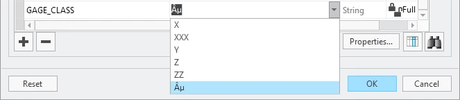

when making a restricted parameter with a text document i use µ in one of the options, but in creo when selecting the option it shows "µ" instead of "µ".
i tried some other sybols and it does the same thing with the Â
annyone know whats going on?
Jul 26, 2022 7:34 AM UTC
it is indeed a problem with the UTF-8 that should be UTF-8-BOM
https://www.ptc.com/en/support/article/cs288478
so i did save as, and at the bottom you can change the UTF-8 to UTF-8-BOM.
after updating the restriction definition it works

I'm not sure if Unicode is supported in restricted parameter files.  Is the text file encoded as UTF-8?
Jul 25, 2022 2:06 PM UTC
i dont know what unicode is or how to tell if it is encoded as UTF-8. but its a .lst file it thats what the question is
TomU
Jul 25, 2022 3:16 PM UTC
I'm seeing the same thing.  You probably should open a support case and see what tech support has to say about it.
