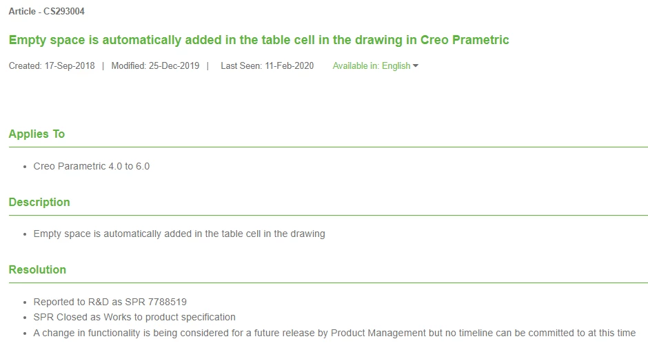

@gkarthikyn wrote:
Hai, in Existing revision table . if i enter data (Like ECO, date, name ) i am getting an extra space at the end. which makes the data not centered in the particular cell of table. to Fix this i have to manually edit data and delete extra space to make it to center.is there a way to fix this using map key? every time data should be in center of table without any extra space.
I think the problem was reported in CS293004 on 17-Sep-2018.
Result ... Works to product specification.
February 12, 2020
i am unable to view that information in that link. it says "
Maintenance Only Article"?
