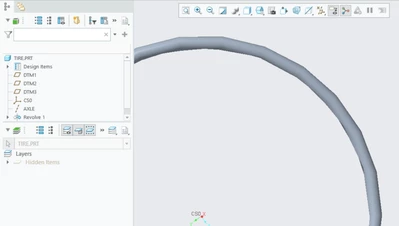

Hello guys.
I'm sorry to ask such a dumb question, but I'm absolutely stumped on it. And it's REALLY dumb.
The attached model is a simple revolve of a 25 mm wide tire profile with a 700 mm radius out to the rim. (Yes, it's not realistic, but this problem happens even if I reduce the radius to 400 or 50 or whatever.)
The revolve feature ends up all chunky, instead of smooth. If I reduce the radius to 50 mm, the inside of the feature ends up all chunky instead.
I have changed the model accuracy both up and down and nothing ever changes.
Thank you for advice on how to get back to the regular, smooth revolves that I know and love.

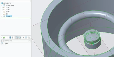

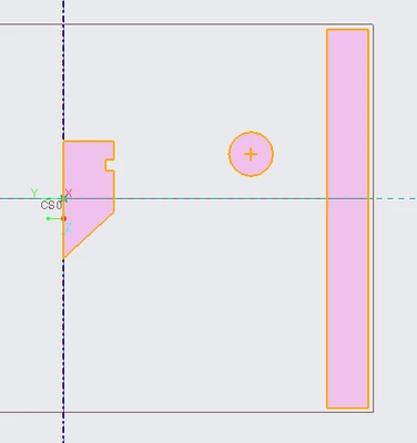

OK, I think I see what's happening. Tourus-shaped revolves have this, but cylinder shaped ones do not. With this sketch:
I get this revolve, showing both the nice smooth edges I was expected, and the blocky edge (on the torus in the middle).

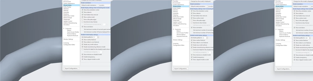

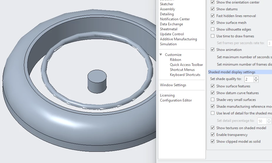

this is definitely shading quality related (set to 1, 5 and 20 in the screenshots)
Why the shading quality setting only seems to apply to non ruled surface types, I do not know.

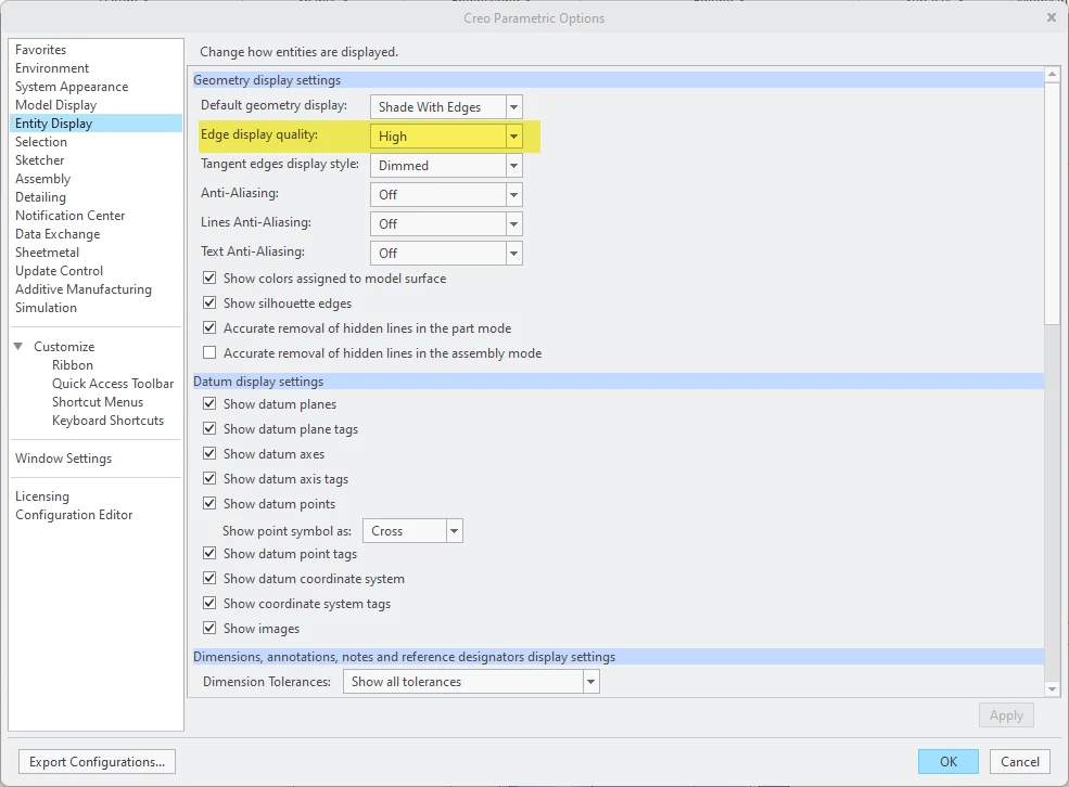

Try setting the edge display to high or very high and report back on the results of doing this.
File->Options
Oct 17, 2023 4:02 PM UTC
That did not fix it. (Mine was on medium.)

Try increasing the shade quality if you have not done that before. It is most likely a display issue. Post the model if this does not work, so it can be checked in a different environment.

Oct 20, 2023 8:03 AM UTC
