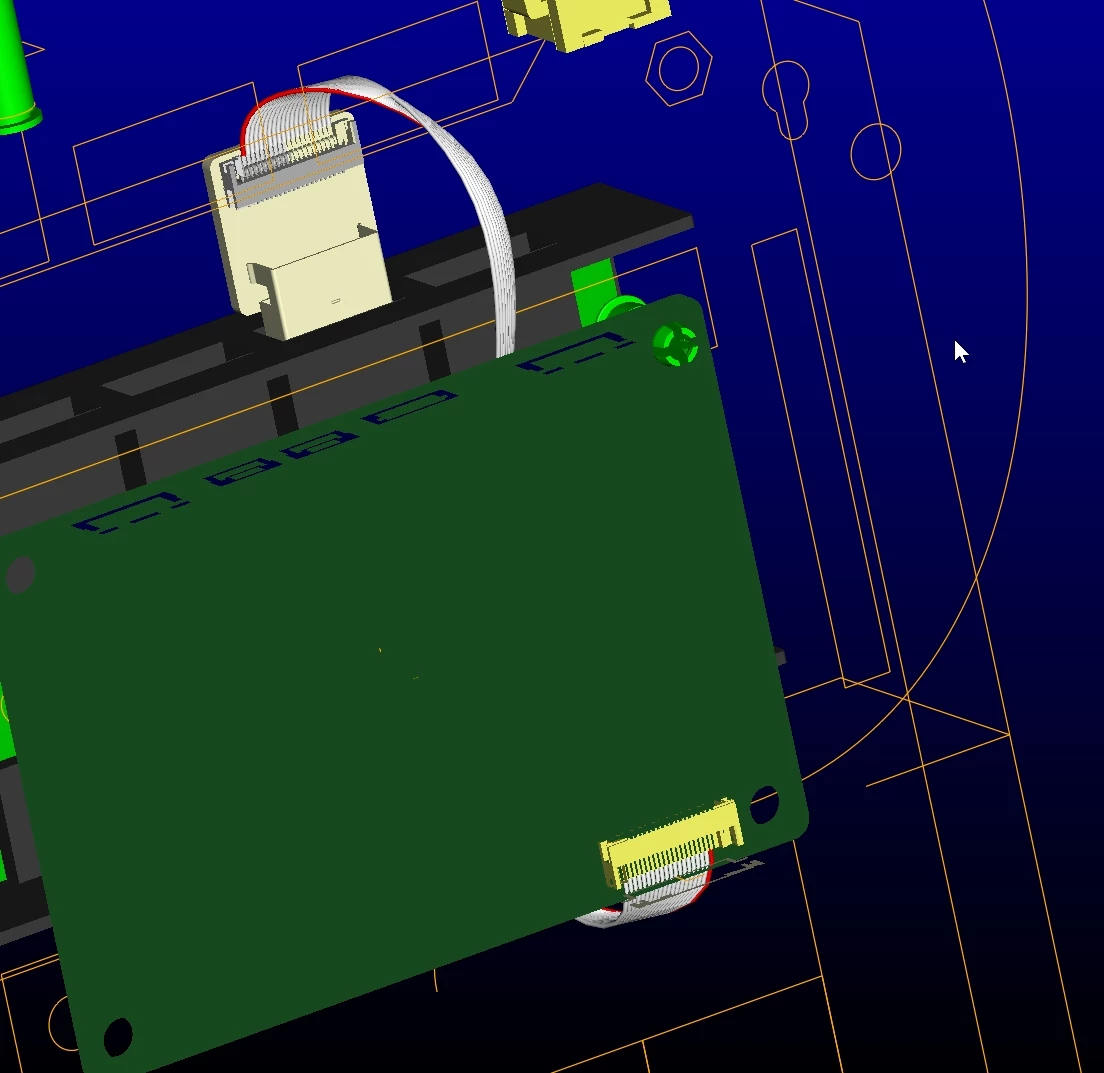

Hello!
I have the problem, to control the twist of ribon. I rotate the coordinate systems without result. How to do it?
Thank you in advance!
Greetings!

How is the geometry for the cable created? If it is a sweep then you can use a variable section sweep and "clock" the section using a relation defined as a function of the internal parameter "trajpar". This will enable the twist of the cable as it is swept along the trajectory. You will need to define a clocking reference in the sweep sketch and then add an angle dimension and then write a relation for that angle as a function of trajpar.
This thread may help you get started.

Sep 29, 2021 3:25 PM UTC
No. no.. CABLING!

Edit the routing of the cable and include folds and/or bends along the route.
