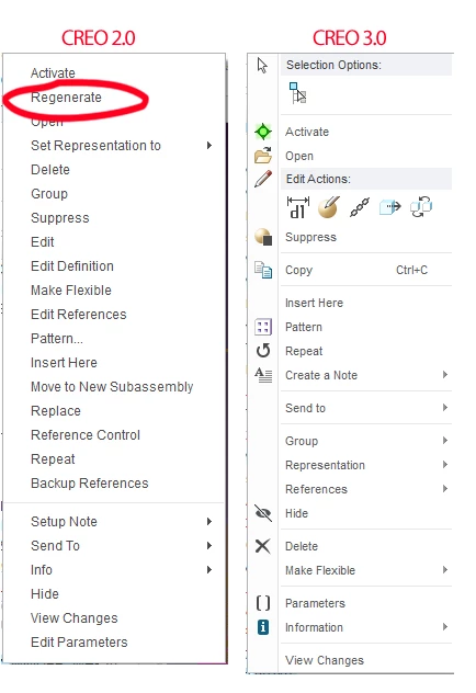

Hi there
wondering if anyone knows how to regenerate a single part in an assembly without having to regenerate the whole assembly.
In Creo 2.0 I use to be able to right click a part on the assembly tree and regenerate that part via the popup menu, however in Creo 3.0, the right click menu is missing the option to regenerate. Attached is a screen shot of the popup window on creo 2 and 3.
Is there a way I can get the "regeneration" option back in creo 3.0?

Hi Lisa & Steve,
If you have a PTC account, you can get further information via the following article:
CS195374 - "Regenerate" does not exist in context menu of a component in assembly in Creo Parametric 3.0
If you don't have an account, you can create one here.
The gist of the article is:
  • Using RMB > Regenerate after selecting a particular part/component, did not regenerate the component selected
    • Regeneration would take place on the entire assembly
  • Since this was not in the spirit of the context command, it has been removed in Creo 3.0
