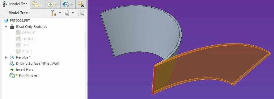

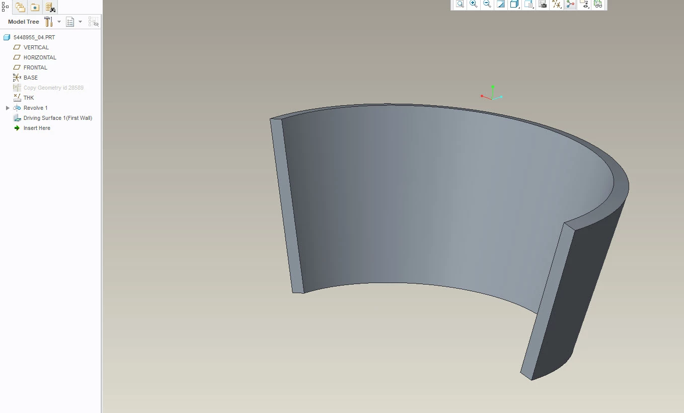

Can CREO sheet metal module unRoll the part ?
Any hints how to unroll the part shown on picture?
December 16, 2019
The sheet metal design package is designed to work with bent parts, not rolled ones.
There are other tools to unroll a part. Most involve the neutral axis, since the rolling process on that shape does not really stretch or compress the material the way a bending process does.

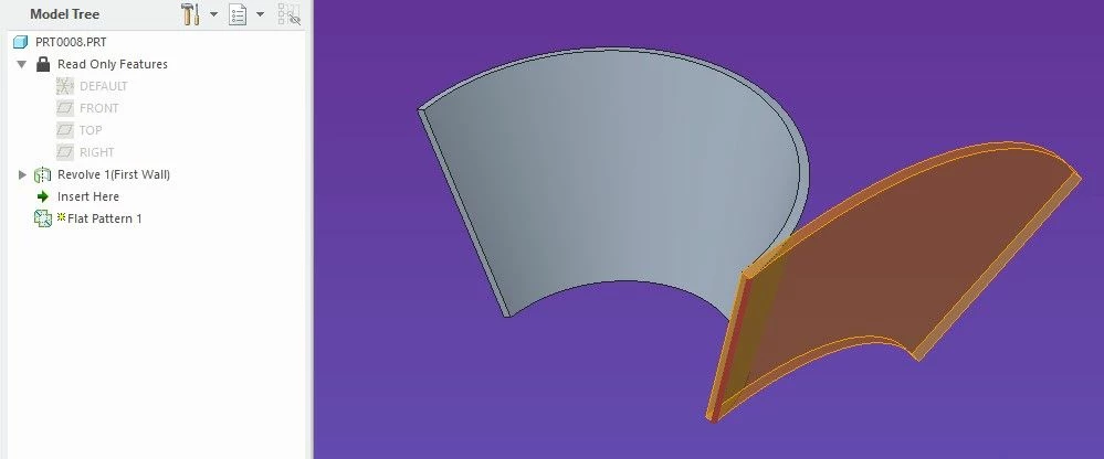

January 3, 2020
Yes
I was able to flatten from conversion and built in Sheetmetal.  Unbend also worked.
