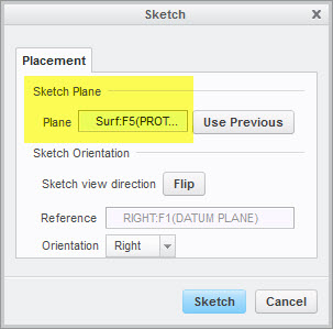

You can select a new Sketching Plane.
  1. Redefine the feature
  2. Redefine the internal Sketch
  3. Sketch > Setup > Sketch Setup
