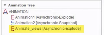

To animate between defined model views you need to use the "Explode" type animation, not snapshot.
The type should be shown in the Animation tree as seen here:
