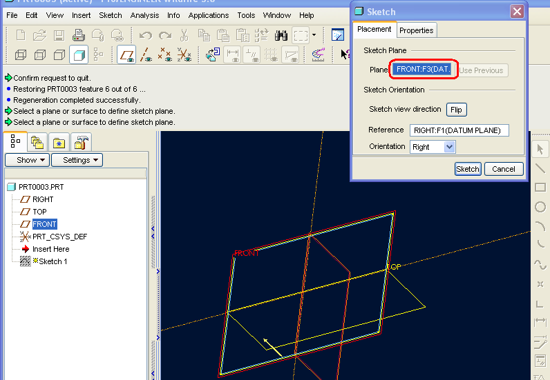

Hi
I would like to explain in details if you are in part mode
if you are in part mode and your model is a simple one
then go to the sketch of the first feature
go to Sketch>Sketch setup
Now replace the plane(see the image)

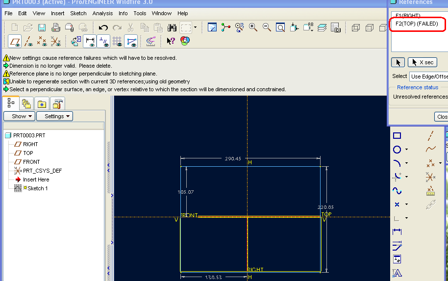

After this you may face some conflict in your references
delete the failed references and add new references or replace the failed references
This is a little tricky and should be done carefully
