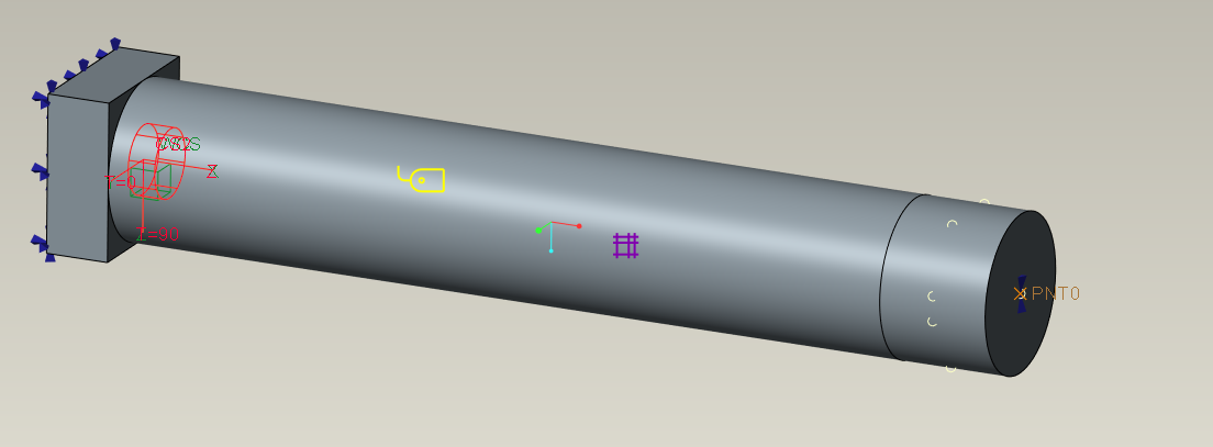

ok, I have wrtitten that the using of rigid link is OK for the rotation. I define the rigid link between a point and a surface but it doesn't operate.
This is my testmodel with cylindrical coord. system:

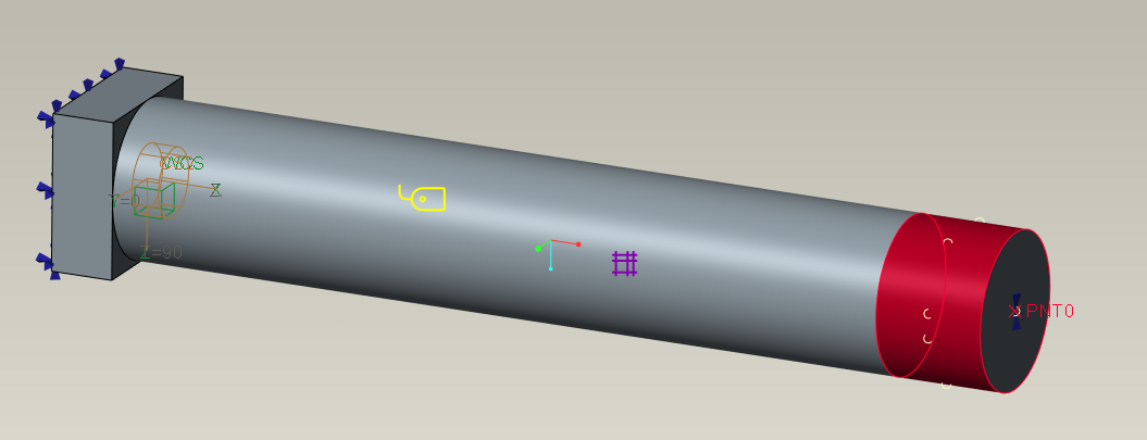

It is the point and the surface for the rigid link:

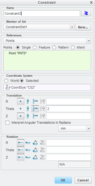

And the displacement:
Based on results, the rotation doesn't occur.. What is wrong? The rigid link?

A couple of thoughts:
  1. You seem to have tried both solutions at once.  Either try the rigid link with a Cartesian constraint; or a cylindrical theta displacement applied to the outside edge of the end surface (I think the units of theta are mm).  I'm not sure how a point will respond to a theta displacement, given that it has zero radius.
  2. I've had problems with points on the model geometry (they seem to become nodes of solid elements) - try moving the point out into free space.

I've used Creo 3 M110 for creating the attached file.
I've no used rigid link related to a point for imposing a rotation.
In my example the goal was the rotation of 2 mm (arc) and I done this in two manners: by imposing the linear rotation and the angular (radiants) rotation.
