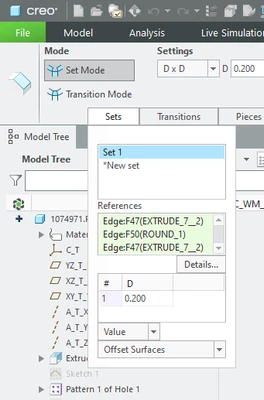

Hi all,
is it possible to default a round/chamfer to always go into a single set without needing to hold control? i've tried looking around but no luck so far.
not super critical for my workflow but i would prefer to manually select if i want to make a new set.

I do not believe this is possible using the UI customization file. It would not be consistent with the selection paradigm used in the UI for this use case.
In theory it is possible that you could create a custom version of the round feature that activates the CTRL key by default for selection, but you will need to use third party apps or code to do this. AutoIt scripting may be capable of doing this.

You may also adopt using intent edges and chains for rounds which grab all associated edges paramagically.
