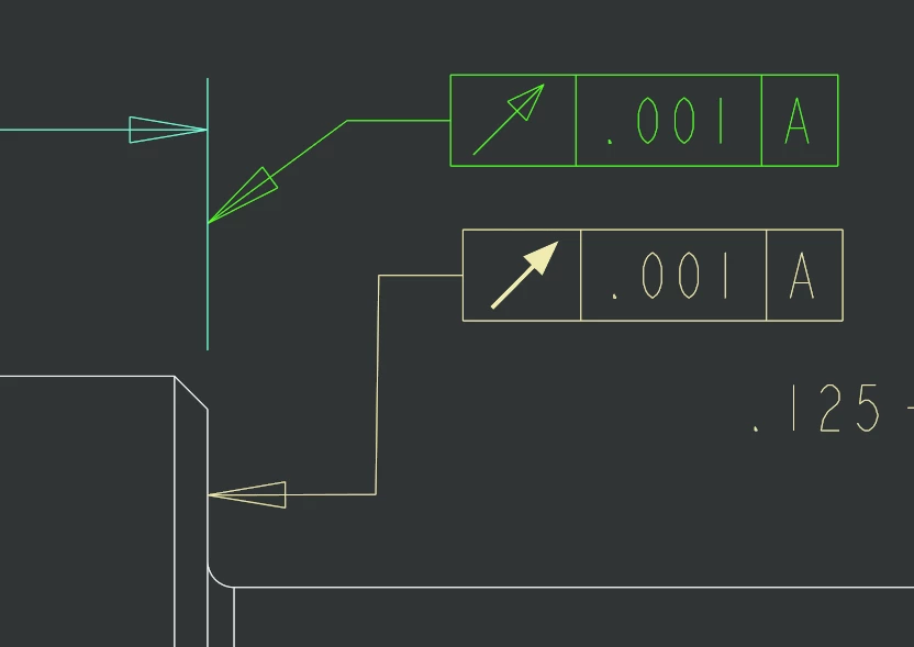

Runout callout (GD&T Feature Control Frame) symbol arrow changes from stroke to filled.
So I've been working on a very simple part with some GD&T callouts and have now encountered my fourth issue trying to do basic annotations (Creo 6). This time, I've noticed that attaching a runout callout to a surface results in a filled arrow in the feature control frame (I'm not talking about the leader arrow). When attaching to a witness line extending from the part object line, the symbol in the feature control frame turns into a stroked arrow. See attached image. This is frustrating because attaching to the witness line is the only way I've found to enable a gap between the FCF and the object line when placing the FCF against a surface.

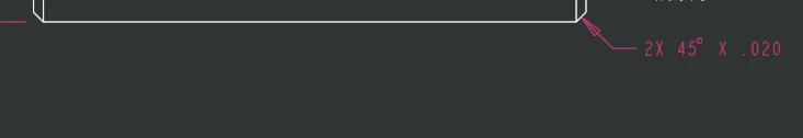

Another question so I don't keep making posts, how does one callout a set of chamfers that were all made in one set of the chamfer feature tool? Show Annotations gives me AxD dimension, but not the 2X callout. I added the 2X in the attached image, which is not parametric and thus not preferred.

w/r/t the chamfer question.
That is how Creo works.  There is no way I'm aware of to make Creo chamfer feature 'count' the number of chamfers.  I have always just created a non-parametric note.
Also, remember, AxD is the way to go since you can always change the angle to something else.  45 x D will always be 45 degrees and not modifiable.
w/r/t the GD&T I don't currently use them but that is quite frustrating
