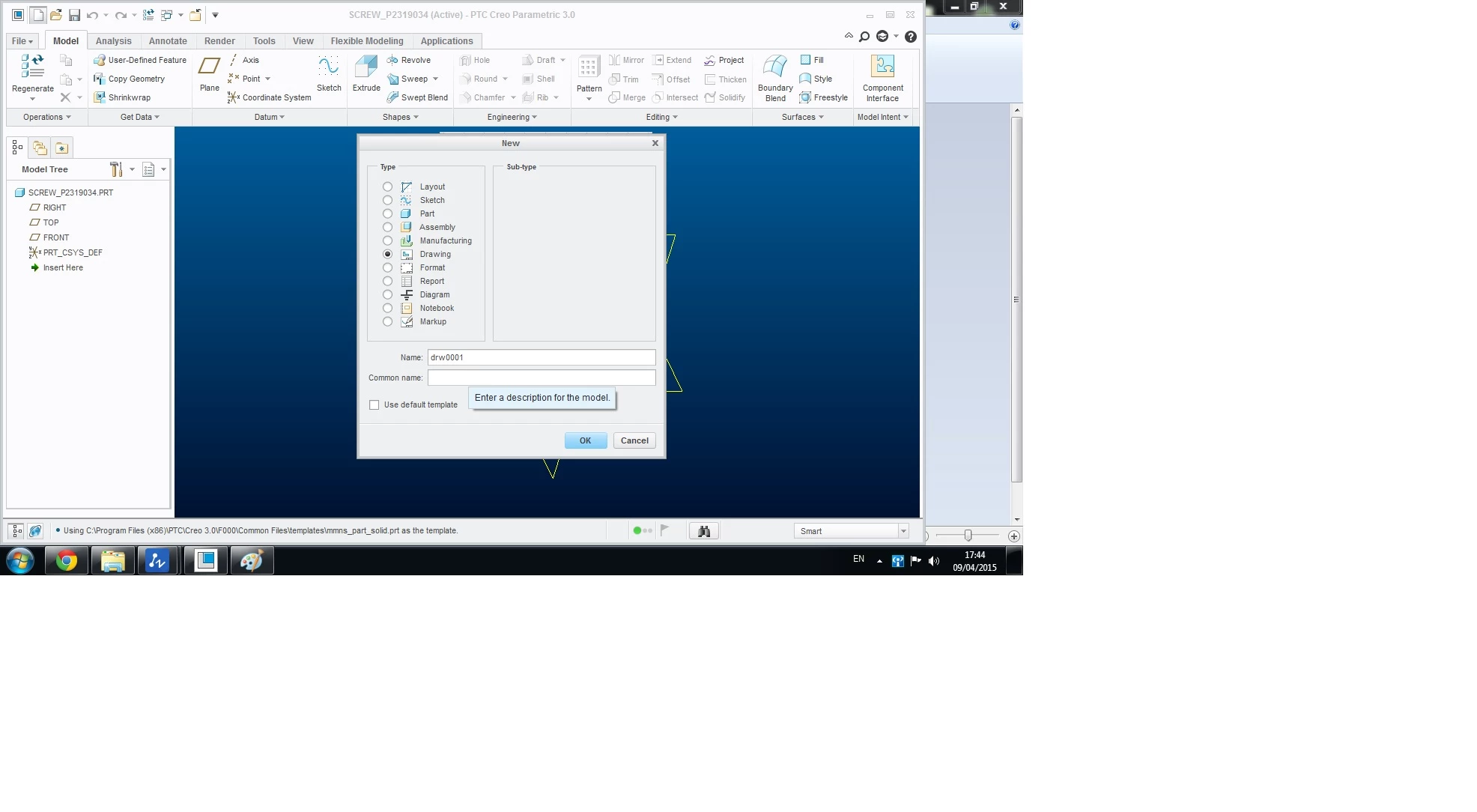

hello people
i have a question
i draw a part screw_p2319024
it is posible to make same name in drawing name without type on keyboard same name?
i want when creating drawing file that have the same name as part of Automated
is posible the drawing have name screw_p2319024
