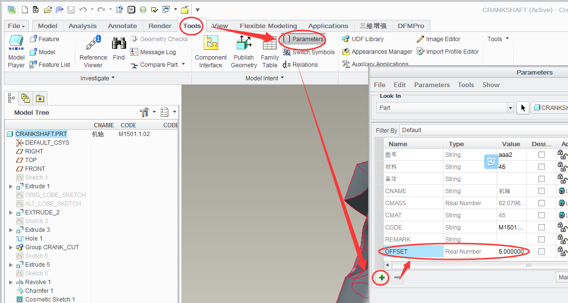

I would like to create a snap line in drawing file. offset Value of this snap line should be governed by parameter value. Is it possible?

Is there any other way to do so? I need to move dimension based on master model for different values.

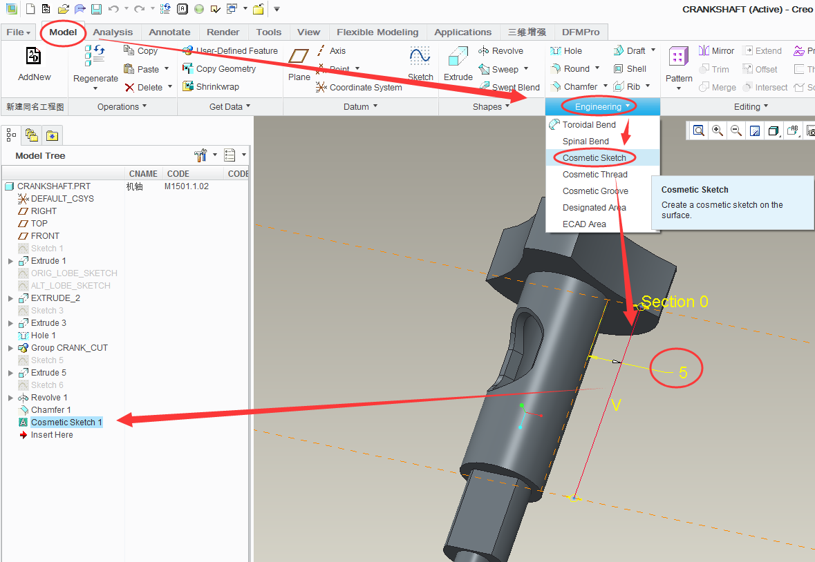

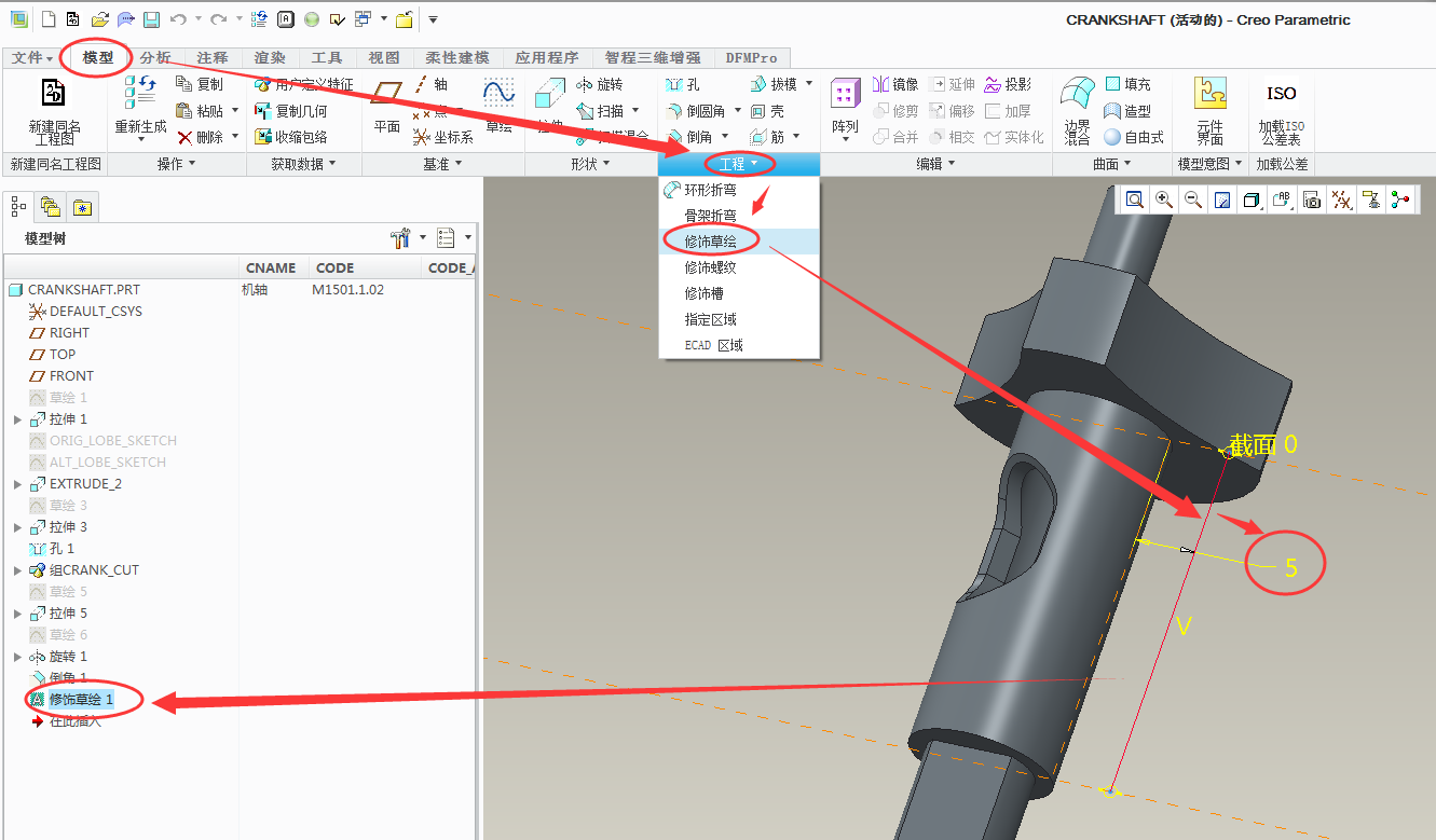

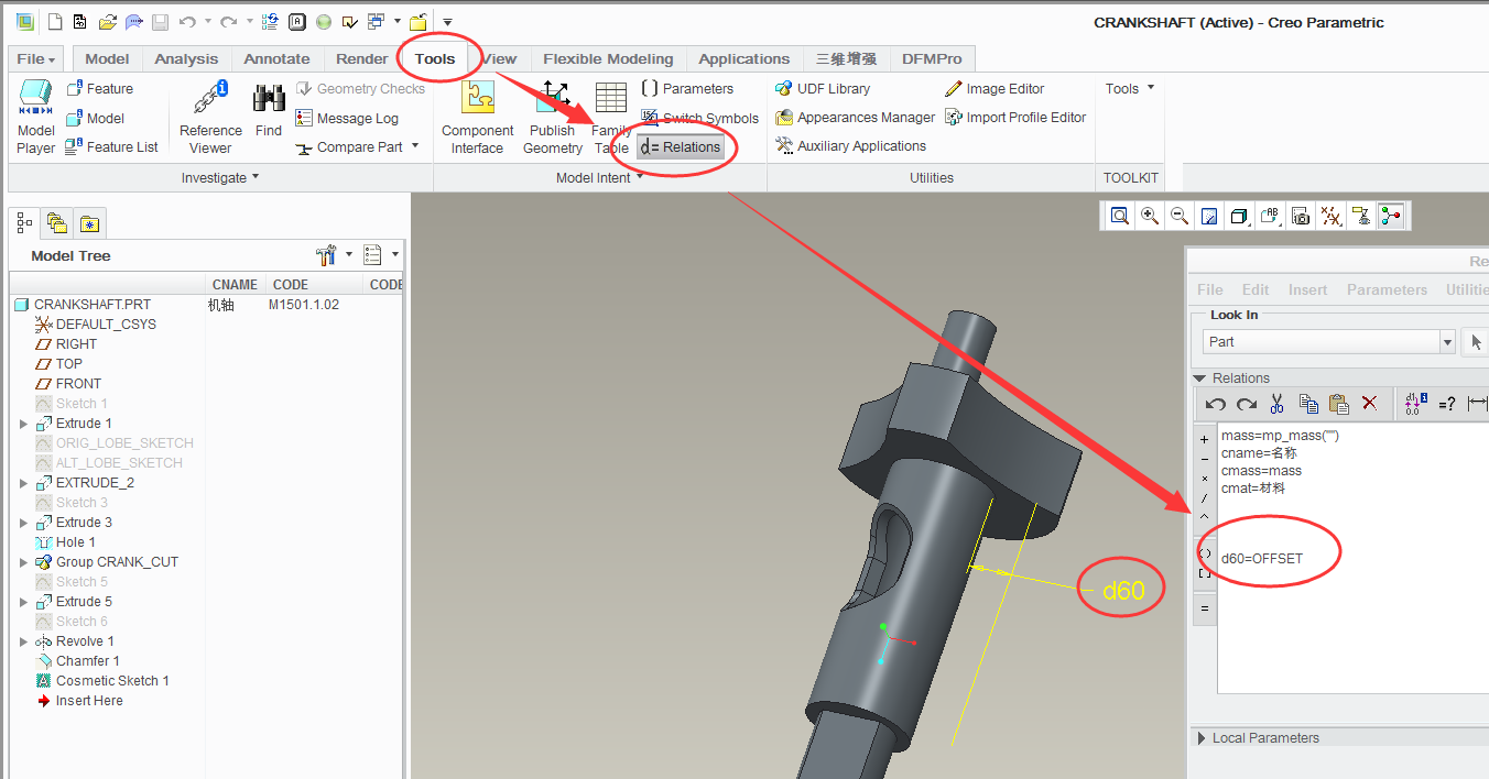

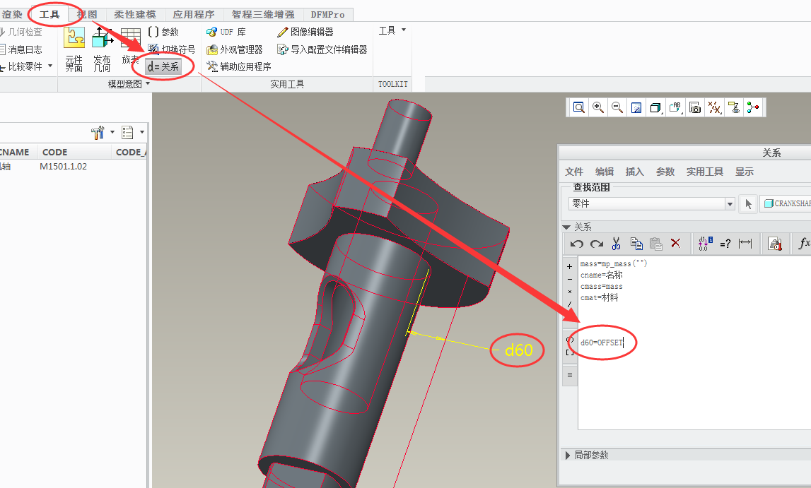

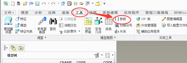

You can create this wire in the 3 d model, can get the projection lines in engineering drawing.
Operating as follows:
