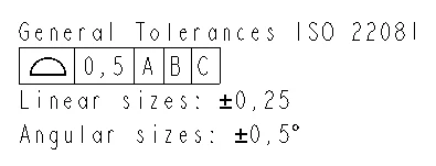

I wish to save this note as a symbol, but cannot get the feature control frame to come through. How can I save this other than an image?

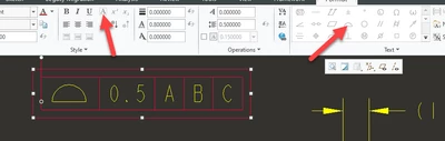

Instead of making the FCF as actual GD&T feature, make it as a note utilizing the box function and symbol pallette within the note creation ribbon.

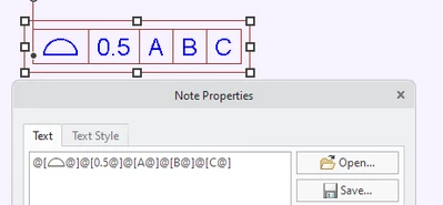

They should copy just fine.  The box button is just inserting the box defining text into your note ( @[***@] )
If you look at the properties of the text, in the text tab you will see:  @[⌓@]@[0.5@]@[A@]@[B@]@[C@]
