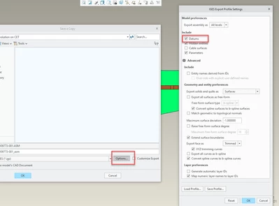

save as iges does not export shown layers and points
I am using Creo Parametric Release 10.0 and Datecode10.0.5.0
in Creo 10.0.5.0 when saving an assy as an iges (save-as), the iges does not shoe datums and points.
Here are the errors that I faced
n/a

Check the options for the export.

Hi @gdesantis
Inline with information shared by Stephen, below articles may help.
https://www.ptc.com/en/support/article/CS180929
https://www.ptc.com/en/support/article/CS302035
Thanks.
