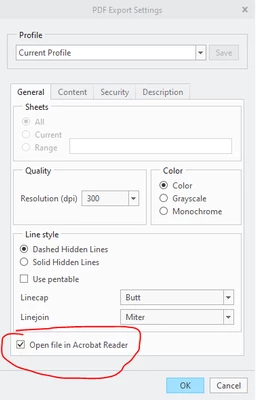

Save As PDF - Open file in Acrobat Reader - config option
When doing a "Save As" pdf, the read opens unless you uncheck "Open file in Acrobat Reader".
This last for as long as the session does.
Is there a config option to "uncheck" this permanently?

Aug 10, 2022 5:04 PM UTC
What we have done is saved a PDF export profile that has that box unchecked and created a mapkey to use that profile.  You'll need to set config option intf_profile_dir to the folder the .dop export file is saved to.
There is not a config option to change the default PDF export settings to a modified version.  An idea to do this has already been entered. 464380

Dale_Rosema
Aug 15, 2022 12:38 PM UTC
I have created a PDF Profile. Now I am trying to set it with a mapkey.
How do I call it without creating a .pdf?
I would like this to be a stand alone mapkey that is run after starting up Creo.

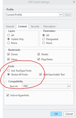

Dale_Rosema
Aug 15, 2022 1:50 PM UTC
I also checked the "Stroke All Fonts" on the "Content" Tab.
