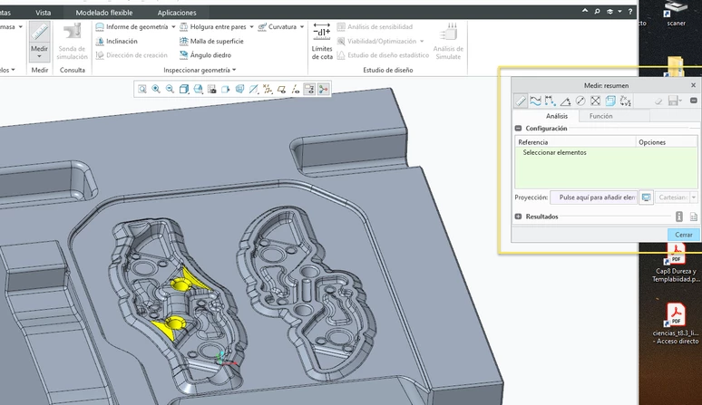

I would like to ask you if it is possible to save the position and size of the pop-up windows in Creo 8, so that when you close and restart the program, they appear in the same position.

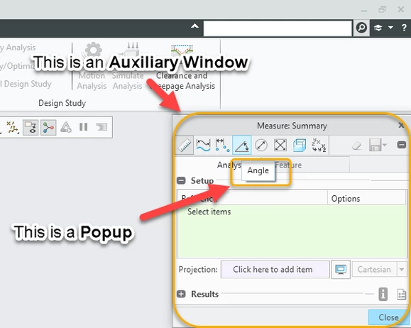

    Just for information, please consider first that, from a terminology perspective, the kind of User Interface (Measure: Summary) you show in your snapshot is what we call an Auxiliary Window and not a Popup (see snapshot below for a better understanding). Sharing info with you to introduce what follows next, but also to help you using the good terminology if you would like to pursue your investigation and use the good keywords while searching in our Knoweldge Base or Help Center locations later on.
    Related to that, it's unfortunately currently not possible to set a custom default location and size of an Auxiliary Window in Creo Parametric. You can do it after having launched the command, but if the Auxiliary Windows is closed and reopened (even in an ongoing session), it will automatically always come up with default location and size. We officially document this current limitation in our article 216509.

    In this case, I am referring for example to the pop-up window of the measure command, that when you open it it appears in one position and size; after closing the window and measuring again, it reappears at the starting location. Can I customize the position and size of this window and save it in the customization.ui file so that it appears in the same desired position?

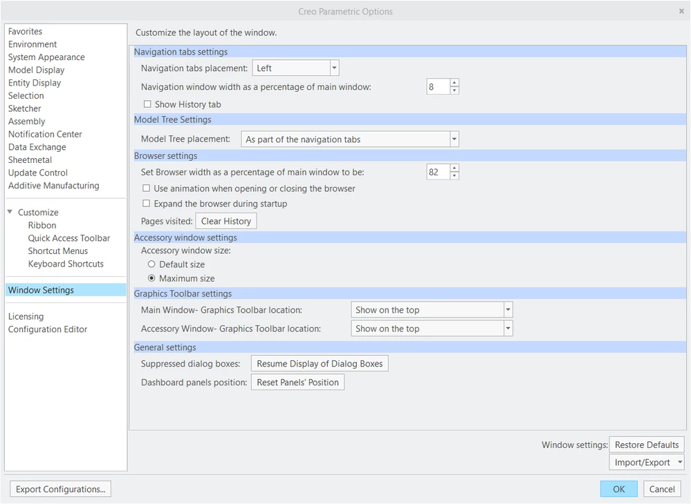

    I don't think you can control that explicitly with the UI customization options. Here are the windows options available in the options tab. I am not aware of any config options that would control this either. You may be able to use one of the APIs to control it with custom software. I am curious what issue you are facing that prompts you to want to control the location?
