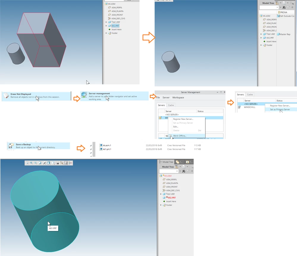

I need to send an assembly to a supplier. But I don't want to send the complete assembly (both for security and convenience reasons). Is it possible to save a stand alone assembly from a Simplified Representation? I only find Copy As External, but that seems to include the complete assy.

Hello Qmatic,
I assume you work also with Windchill..
This is our way to do it: make a backup offline the server
I am working always with the Windchill Server connected.
But as example, I have an assembly of 2 parts, I do a Simp Rep that only show one part. Save the assembly > Erase not displayed > Server Manager> WorkOffline and set No Server as a Primary Server>Save a BackUp
This backUp only have the assembly and the only part of my Simp Rep.
When you open this local copy, Creo can not find the second part... it's not perfect, but it is fine for us. I hope it helps you.

Qmatic1-VisitorAuthor
March 22, 2018
Thank you albert_t!! Yes, I work with windchill as you say. This was a very clever solution, indeed! I would never have worked that out.
