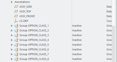

I have a created a large assembly of an industrial air compressor which contains every option we offer on the machine. These options are broken into option classes which are grouped in the model tree (see photo). Every option is part of a Simplified Rep I created called EMPTY and set to EXCLUDE.
If I expand each option class one at a time, select one option from each, and set it to MASTER REP to build a specific machine, can I save these MASTER REP options only as a standalone file that does not reference the original assembly in any way? I know I can Copy As External but that still references the original assembly.
