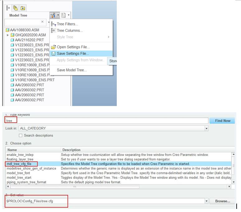

That first link is correct. I'll try to spell it out here for future searchers.
In the Model Tree Settings dropdown, first set the Tree FIlters and other options as desired.
Then, in the Model Tree Settings dropdown, select Save Settings File. Save this file somewhere. I saved it with the config file.
Go to File -> Options -> Configuration Editor. Add the mdl_tree_cfg_file Option Name with your previous settings file as the Option Value. All set!

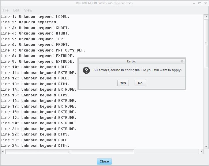

When I do this I get this error. What's it not seeing?

Hello Jeremy
Fist save the setting file , the name of the file will be tree.cfg , save to some location , you can import this every time when ever you need this settings , Or you want want this sitting file to load by default on creo startup. you have to make some changes in the config.pro file
Give the tree.cfg File path to the value mdl_tree_cfg_file.
