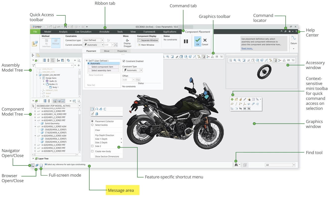

This could be caused by many things as already mentioned by ​@StephenW . Monitor the Creo session performance and look at the trail file(s) to confirm that the command to save the file(s) is actually executed. I would also monitor the file explorer in Windows to confirm that the saved files are actually written to disc until you find the root cause. Open the trail file immediately after a “failed” save and then look at the end of the file to see if Creo attempted to save the models. While using Creo also take note of the message area while you are working if something is not working as expected.
Note the information in the message area
If you ever use the save a backup option, it could cause the symptoms you are describing by saving models to a location other than that which is active or available when Creo is restarted. If you are using this option, then you need to understand how it works to avoid data loss.

The first troubleshooting step for what I would say is very common problems is to watch message log  to make sure it says SAVED. Message logs have options to be turned off or hidden, so this may be harder on some people’s systems. If you run across the problem, review the message log or the trail file for that session of creo and see if it gave a reason for not saving.
