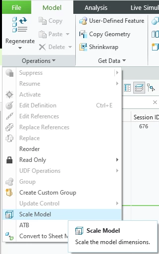

Chris3
Nov 22, 2023 1:29 PM UTC
Model Tab -> Operations -> Scale Model

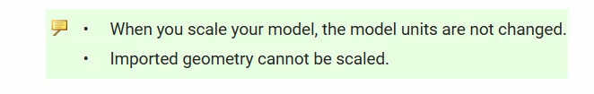

tbraxton
Nov 22, 2023 1:39 PM UTC
Have you tested this on imported geometry? If it worked, please post what version of Creo.
PTC docs explicitly state imported geometry will not get scaled.
StephenW
Nov 22, 2023 3:40 PM UTC
I just scaled an imported solid step file to test.
tbraxton
Nov 22, 2023 1:35 PM UTC
No, it is not possible to scale imported geometry using the scale model function.
Link to specifications on this:
To Scale a Model (ptc.com)
You can probably use the shrink feature from Pro/mold design to do it, although I have not verified this.
About Applying Shrinkage (ptc.com)

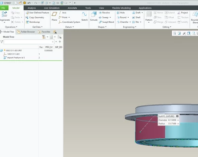

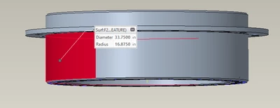

8-Gravel
Nov 22, 2023 1:54 PM UTC
it should be a basic feature
tbraxton
Nov 22, 2023 1:57 PM UTC
Explain in more detail what you need to do and maybe someone will come up with a work around for your issue. If possible, post the import data and explain how you need to scale it.
