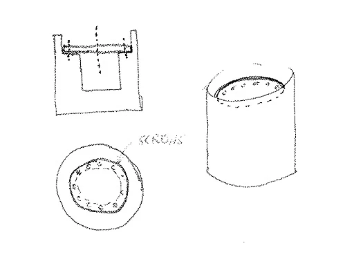

As you can see in the file Pic.jpg, my assembly is a round plate, supported in the inner face of a round structure. There is a screw connection along the contact surface between plate and structure.
At the begginig I wanted to be the most accurate possible. So I created with the Intelligent Fastener  Tool all the screws (10.9. M24x100). Once I had them. What should I do? I started to create "interfaces" (Simulate>Refine Model>Connections) between each screw and plate, and also each screw and structure. Also structure and plate interface. I wasn´t sure about it, there were a lot of connections. In my experience with Marc Mentat in University, you can select easily all the contacts with a contact table.
Anyway I did that. I wasn´t sure so I choose other option: create fastener in Simulate>Refine model>Connections>Fastener
Once I've done it, what should I do? Create also interfaces between each screw with structure and plate?
Also, Interface between plate and structure should be created??
Thanks a lot in advanced, as you can see, I have a "interface" doubt, don´t know

Can't help with the details of how to approach the fasteners; but your part appears from the sketch to have cyclic symmetry.  If your load also has cyclic symmetry, then for analysis purposes I would cut away all but a single 'pie slice' of the model, and just analyse one sector with one fastener.  This will slash your run times and/or allow you to use a much better mesh / more detailed model.  It will also mean you only have to create interfaces and other features for one fastener instead of all of them!

My draw was without details, but not, it´s not symetrical, it has kind of windows, and a hole where an input shaft comes in.
My question anyway:
Should I create always Interfaces?
Because If I don't, the simulation would think that both parts are one (like one piece),
am I right?
