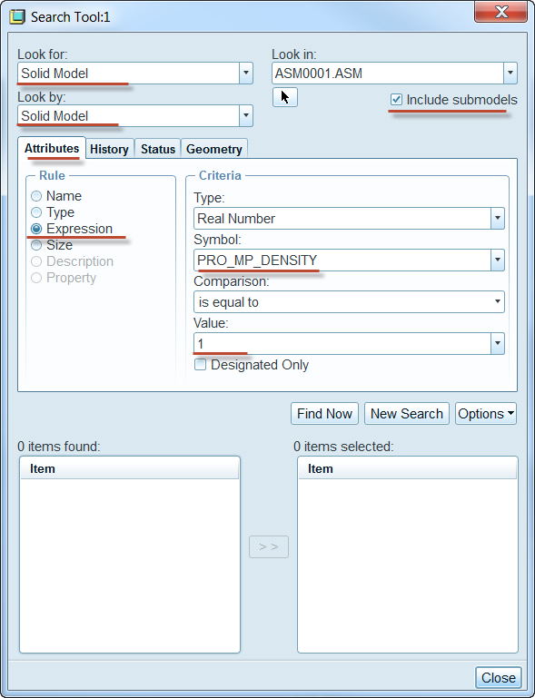

December 18, 2014
John,
You can use search tool for PRO_MP_DENSITY
> Look for : Solid Model
> Look By: Solid Model
> Include Sub models
> Expression > Symbol = PRO_MP_DENSITY (manually type this)
> value = 1
