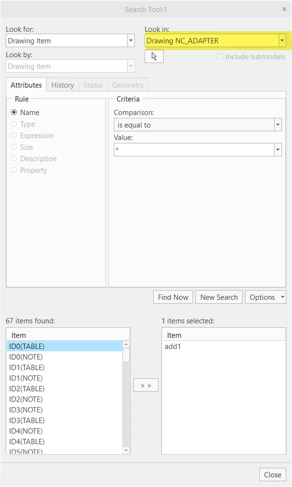

December 21, 2021
As a starting point you can limit the scope of the search to the drawing file. See the example search in the pic. You can build a query using names to find datum tags (name=dt*). You can in theory further filter these using rules.

If the items were created in the drawing, then this search should return it in the results.

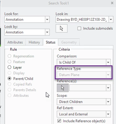

I have several questions about the nested query:
1) In the status tab, i can only select datum_plane in reference for parent/child critera. And as the datum target are put ine the drawing, there is no ref plane.
How can i select an another option, it was grayed out?

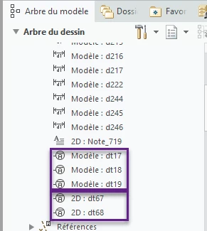

2) the name of the symbol is DATUM_TARGET (it is a creo Symbol)
Iif he is put in the 3D model, in the drawing tree it appear as follow
And if put in the drawing, it appears as follows:
How can i search it with the draft critera?

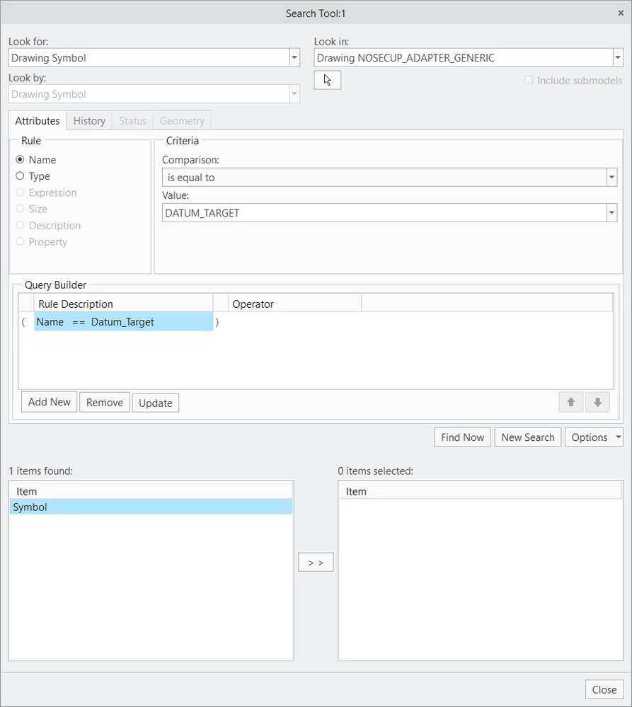

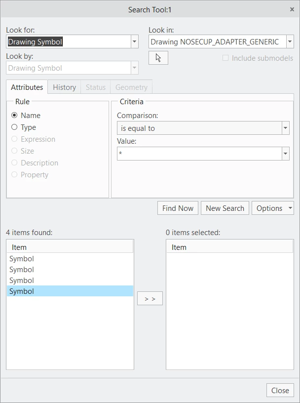

The objects you are noting in the previous post are drawing symbols. This is the search criteria to find all symbols in a drawing.
