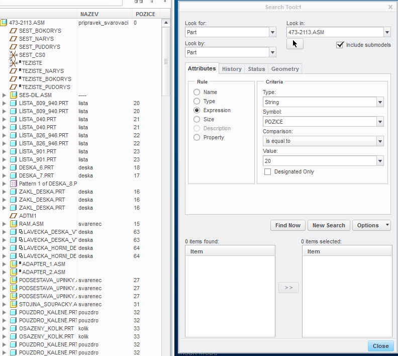

Is there some possibility to search for part in assembly according model parameter?

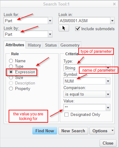

I wish I had an intro to using rules for this. I don't see that it can't work.
I've attached a rules schematic, though PTC probably rearranged some of it for Creo.
I think you want to Look for - Component and search for the Attribute where the parameter = the desired value. Since it's an assembly I suspect Look In will also come into play.
February 1, 2015
Try this settings:
Jose
thlavinka1-VisitorAuthor
February 2, 2015
Hello Jose,
I have tried to search accordin to your settings and it seems it does not work.
B.R.
T.
dschenken2-ExplorerAnswer
2-Explorer
February 2, 2015
Is that because the parameter is not a String? Is the parameter a Real or an Integer? Then the Type should be changed to match.
