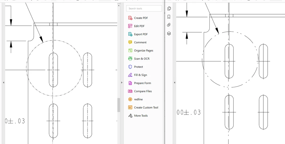

Section and Detail lines are out of scale
since we have upgraded to Creo 9 our Section lines and Centerline scale a seem all out of whack when compared to older drawings. they look normal in the drawing but when exporting a PDF thet look bad. Either the section line scale is so small that it looks solid, or the centerline/Axii lines are so large that they dont show breaks. we are running into instances where we are updating old drawings and its rasing lots of flags because they look so far off.
here are two samples one with configure settting intf2d_out_pdf_scale_line_fonts changed. We are looking at having the Axii from YES and the Cut/Detail Lines from NO
YES                                                                                                                NO

I think it is necessary you to prepare and upload testing data set, This enable community users to investigate your problem.
