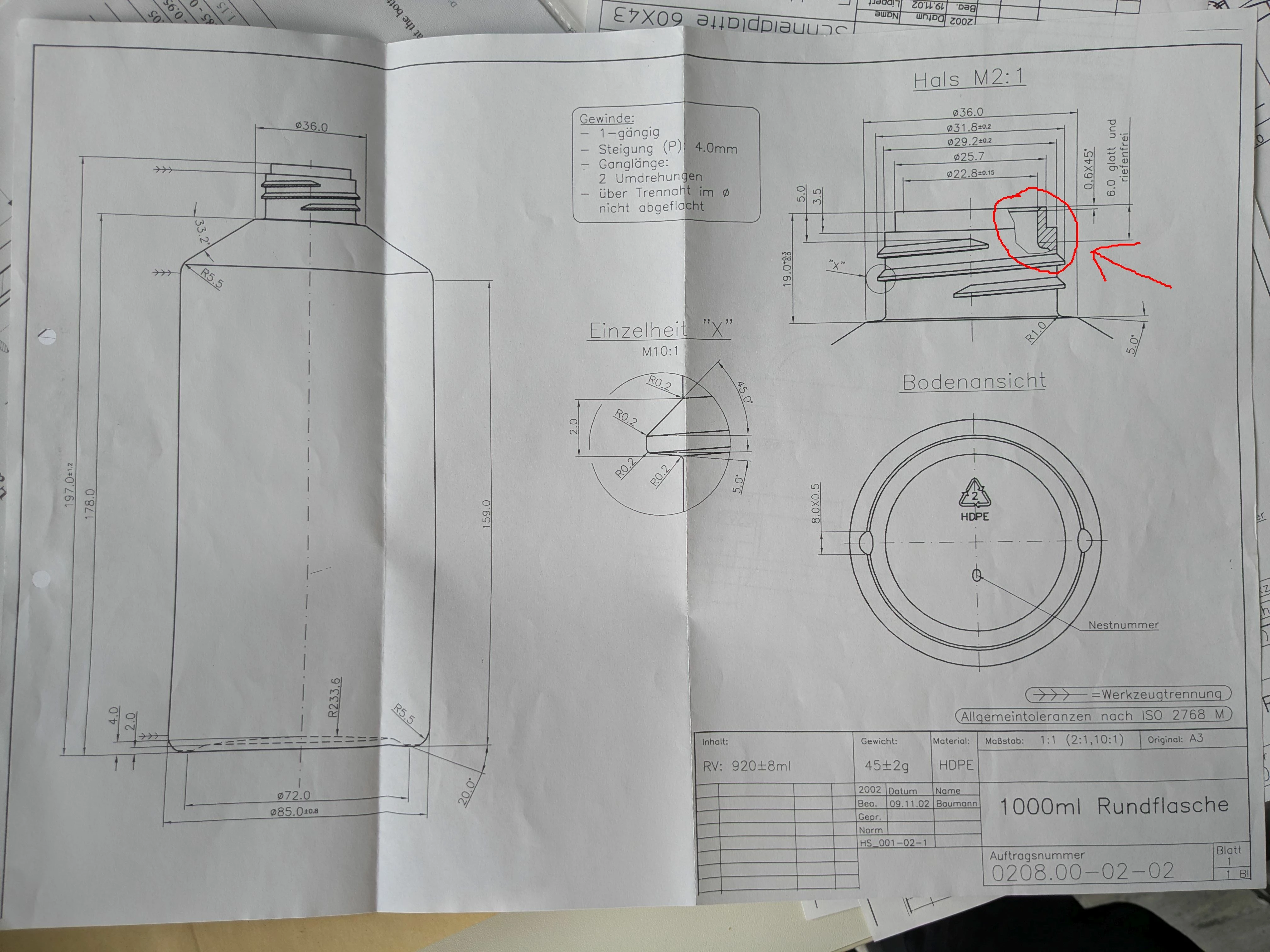

So I’m trying to create a section view as marked in this picture here

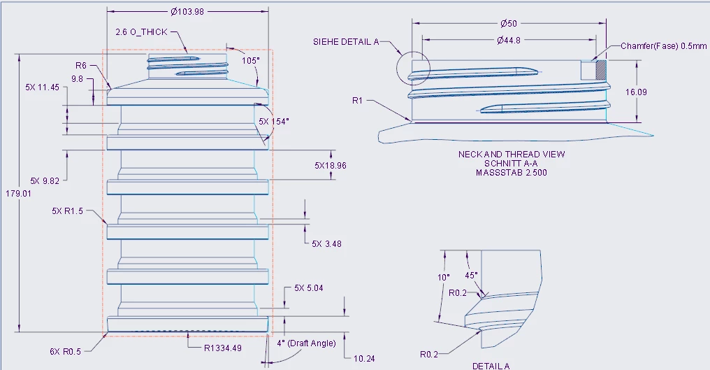

But I’m able to create only like a perpedicular linear section cut in the botttle neck region (Below picture is my drawing)
Please let me know how to create a section view show in the first drawing.

You need to create a local section to replicate the drawing you show. You will not have explicit control over the section cut lines as it uses a spline in the definition of the local cutaway so you will have to play with the spline geometry until it “works”.
Here is a tutorial on section creation including the local type. Local creation is @ 11:30.
https://www.youtube.com/watch?v=ZuU1TZuObvw

Wow, Thank you for the instant reply,
I saw the tutorial and it worked
