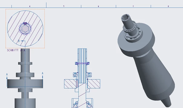

Hello everyone:
I have the following issue with my bearing: In the sectional views, the balls always seem to be fully displayed, and I just can't get rid of it (as in the attached file).
I imported and installed the bearing from the SKF catalog as an STP file like all the other bearings and they word fine.
Please help!

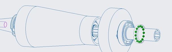

Since they show up purple, I am sure they are not solid and only a surface.  To get them to act as you want you need to solidify them or, in the Drawing View properties under View display check the box for Hidden line removal for quilts - Yes.
