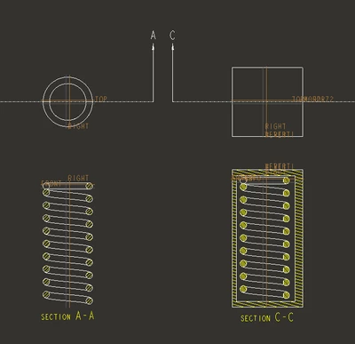

Sections fail when there is a spring inside the assembly
I am using Creo Parametric Release 4.0 and DatecodeM150
Sections have never worked at places where they would cut a spring which is part of an assembly. The section looks fine in 3d, but fails on the drawing. Currently the spring has to be excluded from the section for it to work. Is this a known bug? Will this bug be fixed in Creo 8?

The issue is not unique to springs, and not all springs act this way.  If you can't create a cross section for the spring itself, then there is an issue with how your spring is modeled.
2D cross sections of assembly drawings will sometimes fail to display properly if there is interference between the components.  I've also seen cross sections fail when the section perfectly lies on a vertex in the geometry.  Try eliminating interferences.  If that doesn't work try shifting the cross section slightly (.005") and see if that makes any difference.

Another suggestion.  Try deleting and recreating the cross section.  I have seen issues with cross sections created in earlier versions that didn't work in later versions and couldn't be fixed (even by PTC).  The simple solution was just to recreate them.
There were a bunch of things fixed with cross sections around the Creo 6.0.3.0 time frame.  It's possible that moving to a more recent version of Creo may fix the problems your having.

Not a known bug. Is it just a normal, solid geometry spring? I just went and found a random spring and made an assy and view. I haven't ever seen a problem with a spring in a section.
Jul 22, 2022 11:19 AM UTC
if any of the assembly components contain imported geometry, this can cause the problem.
