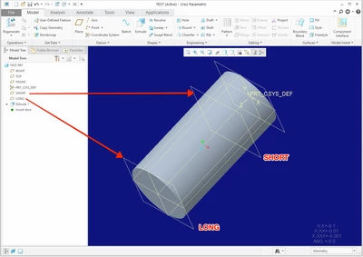

Lets say I have a simple extrude feature, extruded up to a plane. How can I have it end at a different reference (plane, point, etc), based on the value of a part parameter?
Something like:
IF myParam = "Short"
   <reference> = dtm_plane_short
ELSE
      <reference> = dtm_plane_long
ENDIF
I seem to recall being able to this way back in the day with Pro/E, but its been ages.

I don't think there is a way to do this using standard parameter / relations for a reference names.
It is a clever idea ... I would add that to the enhancement requests.
I thought that a UDF might be a clean way to do that - but that does not seem to be any better.

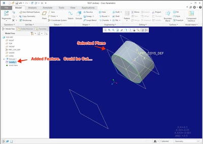

Depending on the complexity of what you are doing ... and the dependencies that would be affected.  You could just model the long version and then use a separate feature to cut to the short version... Then control the existence of the Cut Feature using Pro/PROGRAM using a Parameter Value.
In this case I used a "solidify" operation to effectively trim everything to one side of the "short plane" - then put some Pro/PROGRAM around that feature with a parameter...  The same could be done with a normal extruded Cut.  Seems to work OK.
