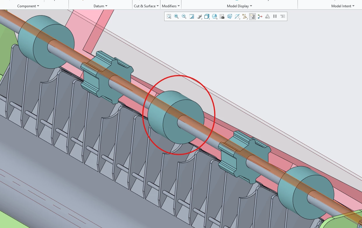

Right now I am working on an assembly with multiple parts with similar geometry. I wanted to know if there is a way for me to select all geometry with the same dimensions/features? Attached below is a reference, where I want to select all roller geometries without having to individually select them.

If these components all have a common parameter or name, then you can use the find tool to collect all of them with a search query.
https://support.ptc.com/help/creo/creo_pma/r11.0/usascii/index.html#page/fundamentals/fundamentals/To_Build_a_Query_in_the_Search_Tool.html

Thank you! Understood
