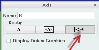

Can anyone explain to me what the differences are between the two choices for setting datums?
[cid:image001.png@01CEB38F.78B92D60]
I use the old style datum because I can layer those set datums off in the model. I can't do that with the new suction cup datum. That's why I avoid them, I don't what to see all the set datums when I'm working in model mode.
It was pointed out to me that with the suction cup the drawing tree has this menu:
[cid:image002.png@01CEB38F.78B92D60]
With the old style datum the drawing tree has this menu: (No Delete)
[cid:image003.png@01CEB38F.78B92D60]
However If you have a datum as an axis, and use the old style the delete option is available.
Other than the delete menu, is there something I'm missing by using the old style verse the suction cup?
What's the purpose of having two ways to do this?

I think I need to clarify what I'm talking about here. I've received several "answers" telling me that the suction cup it the newer standard.
We are not talking about what the datum looks like on the drawing. They both choices look the same on the drawing, they have the suction cup.
In model mode when you "set" the datum there are two choices in the User Interface, "the buttons you pick", which is what we are talking about, show the old style and the new style datum on the face of the buttons. What style you see on the face of the drawing is controlled by the detail setup file.
How those two choices behave in the model mode is different.
* If you pick the old style button, you can use layers to hide the set datums in part and assembly mode. Very desirable. However for datums planes you don't get a delete menu choice in the drawing mode. You do get a delete menu for datum axes.
* If you pick the new style button, you can't use layers to hide the set datums in part and assembly mode. A major bummer! You do get a delete menu choice in the drawing mode.
I don't know of any other behavioral differences between the two buttons. There may be other differences, I don't know why PTC has the two choices.

Hi David,
The middle datum image that has the hash marks (-A-), in the Datum Properties Box, is what is used to actually set an axis as adatum. For instance, Right-Click Axis Y in the model tree, Properties, then click the middle -A- and choose how to apply the datum. If you click the right, suction cup, image, you will be making theaxis a Datum Tag Annotation, instead. If you hover your mouse over the images, there will be a short description of what they do.
Here is some information from the Help File aboutDatum Tag Annotations.
