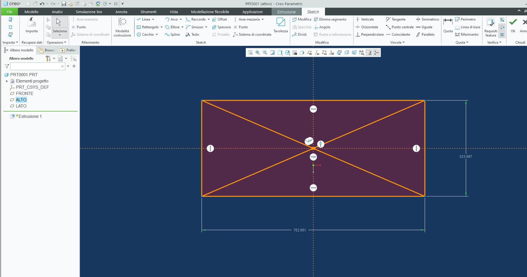

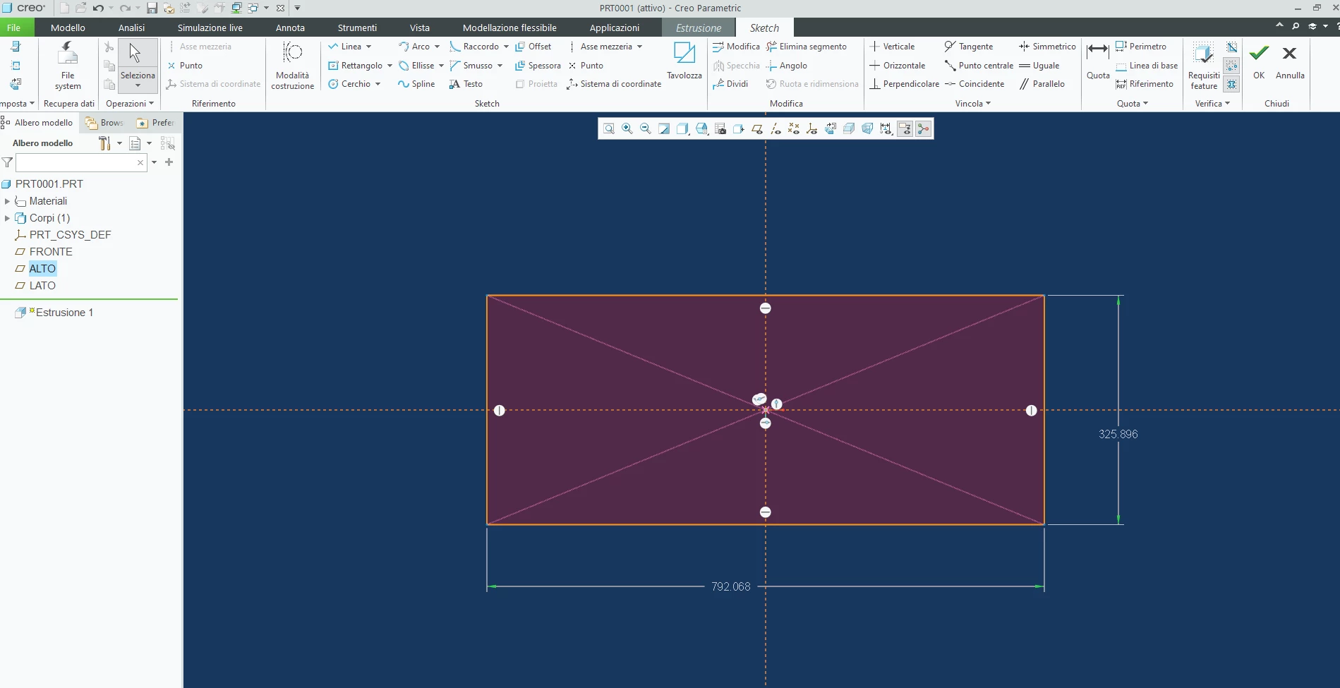

Hello to all,
i am using creo 8 and i noticed that, compared to previous versions, the dimensions in 3D sketch are much smaller.
Where can I set the size from? (see attached images between creo 8 and creo 7)
ty,
Matteo.

what resolution is set on your display ? Maybe you can try to set config.pro options
HIGH_DPI_ENABLED no
HIGH_DPI_TEXT_ENABLED no

September 8, 2021
The config between 7 and 8 is the same but I had two different views.
I tried with the two voices you pointed out to me and now they are also seen larger in 8.
Thank you very much
Matteo
