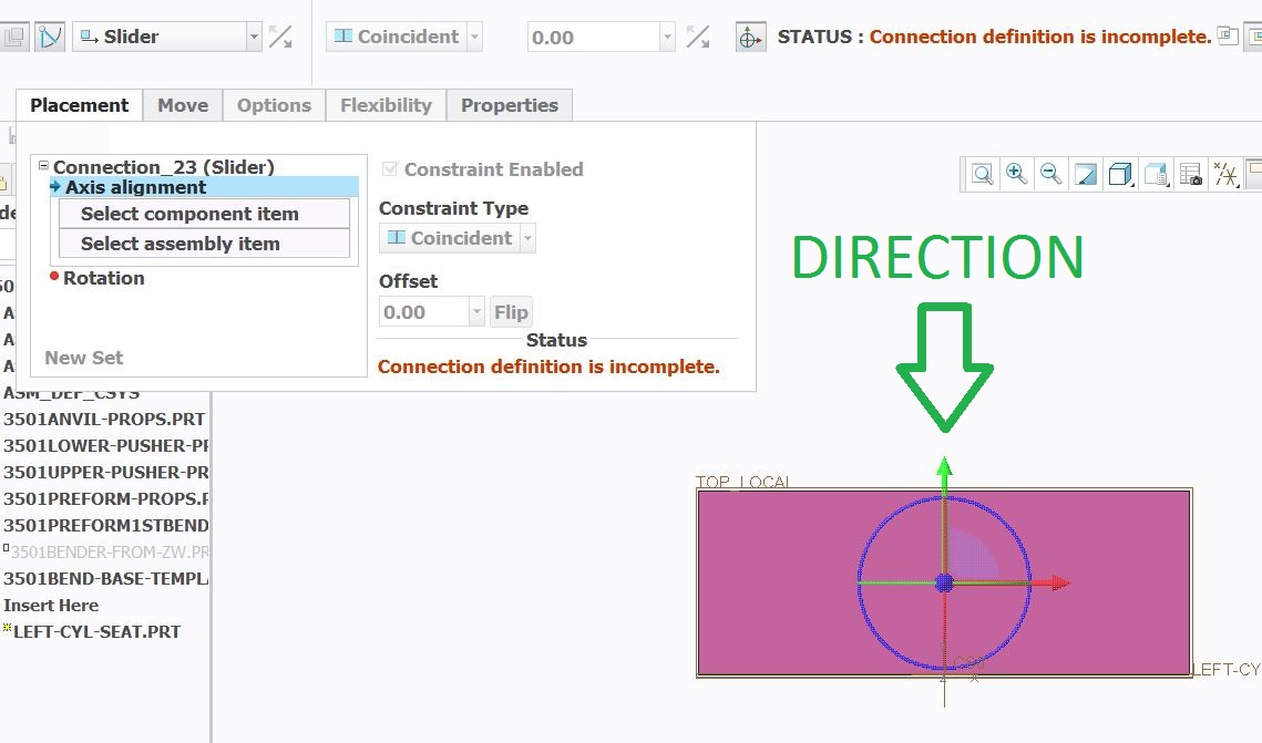

I use basic assembly a lot for viewing models in position.  I haven't however got anywhere with establishing movements or start or end positions within the assembly.  There are a lot of basics I might be missing.
Is there any best practice for setting up start and end conditions in an assembly.

In playing around with this more it would seem that if I could use the slider constraint option that I would be able to select max and min movement of assembled components.
The only problem is that the slider option requires an axis and the movement really doesn't include a corresponding axis to apply with.
Is there a way to define a max and min translated stroke movement without using an axis?

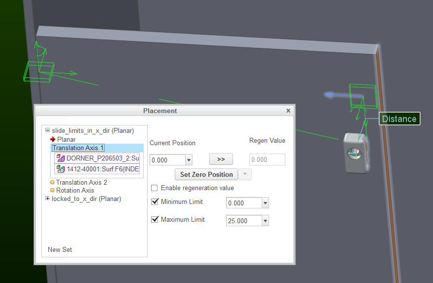

January 25, 2017
Using a slider constraint will work well if you can set up the slide-direction axes and the datums to control the motion limits.
But maybe that's not feasible because you can't revise your models.
Just keep in mind that you can also use edges and surfaces to define these types of joints.
However, it's not that onerous to use a combination of 2 planar constraints, and this a general and flexible slider connection:
Note: the 2nd planar constraint is required because you can't simultaneously specify 0 for the min and max motion limits.
pimm15-MoonstoneAuthor
January 26, 2017
Paul
Your use of Slider looks a little different than my instance using the criteria that populates by default.
I would like to slide the box from it's 0 position to 5 at the end of the cycle in the direction shown with the green arrow.
My example shows up different in respect that yours shows translation axis and mine shows axis alignment.  I don't know what to pick for "Axis alignment".  This just seems unselectable.
Also I just don't know how to contend with the "Rotation" which appears to be necessary.  The green arrow does show an actual axis, but there is no corresponding axis on the rest of the assembly.  I think you might be suggesting that I could use an edge.  If I could get the 1st part to work perhaps the 2nd would also work.
