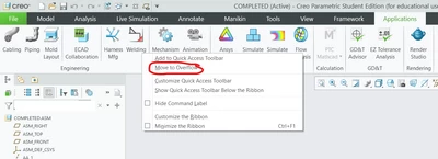

Good day,
I would like to ask for your advice. I deleted the weld window in Applications in the Creo students program. Could you please help me how to get it back?

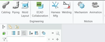

Please check the photos below.
This is the default ribbon.
You can right-click the welding and click move to overflow to hide as I suspect you have done.

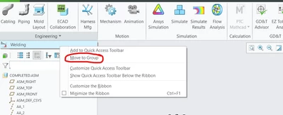

Click the engineering tab to open the overflow menu, then right-click welding and select "move to group"
It should be back to its default place.

Thank you very much. I managed to return it.
